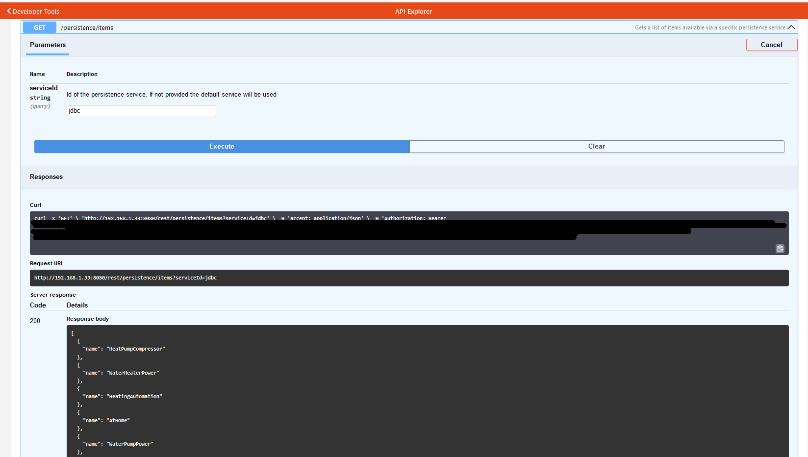

I’m able to read from the mariaDB hosted on my NAS using the jdbc service, using GET /persistence/items

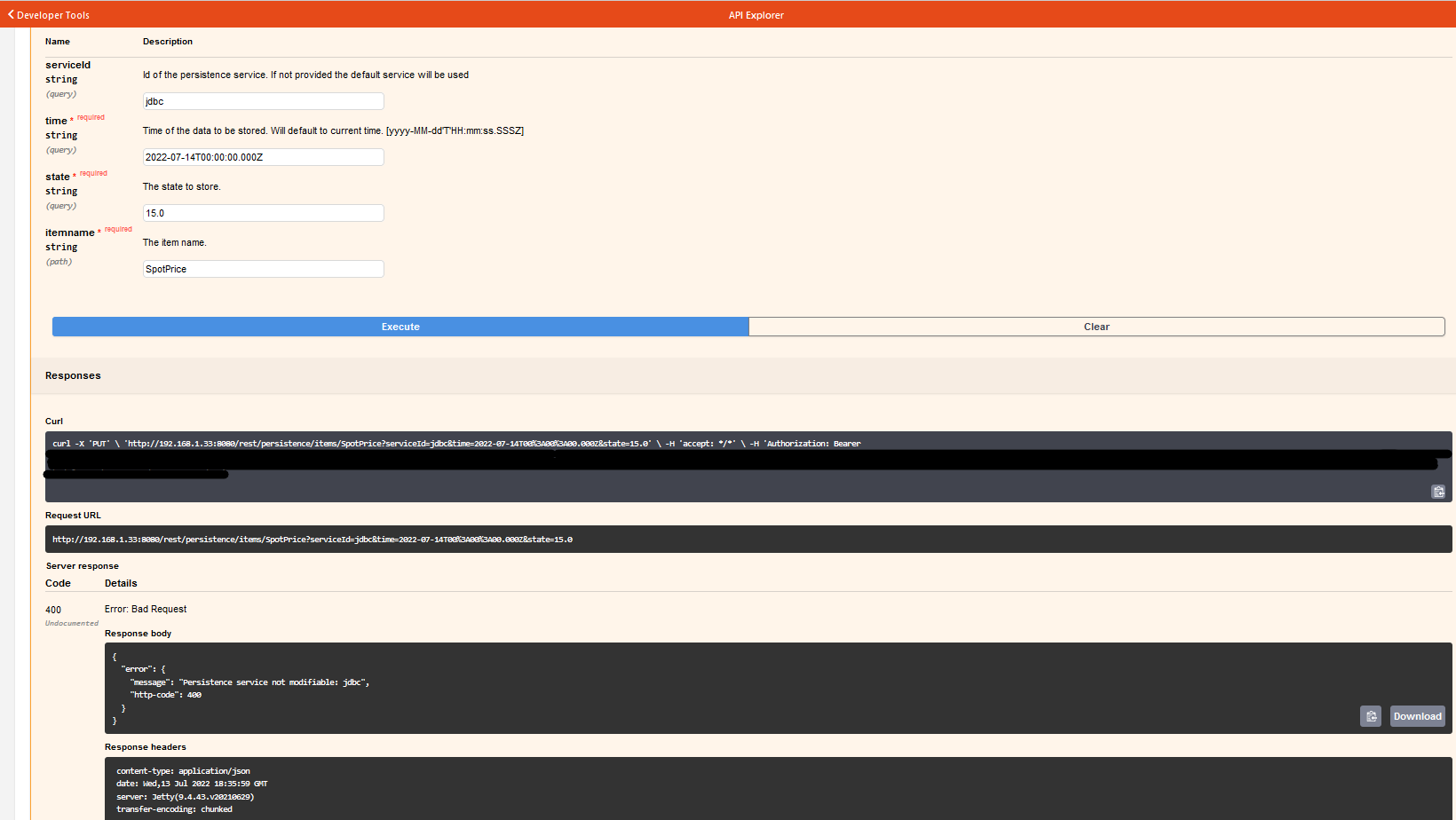

But when I’m trying to write with PUT /persistence/items/SpotPrice, I get HTTP 400 error wth a message: “Persistence service not modifiable: jdbc”
