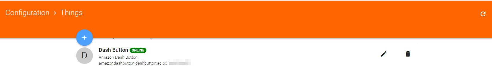

See my picture above. You need to see the dashbutton under “Things” in PaperUI and it needs to say “Online”.
Thing, Thomas, Thing, not Item :grinning: For that little sample rule you don’t need an item at all, only the thing and a dashbutton which is online.

Okay, it your device thing is green and online and you don’t have any errors in your openhab.log that trigger should work.
Yeah, yippieh, yeah … it worked! Unfortunately i’ve no idea “why” .. I’ve re-recognized the DashButton as thing, i think i’ve restartet the raspy some times and suddenly the hue light lit up.
