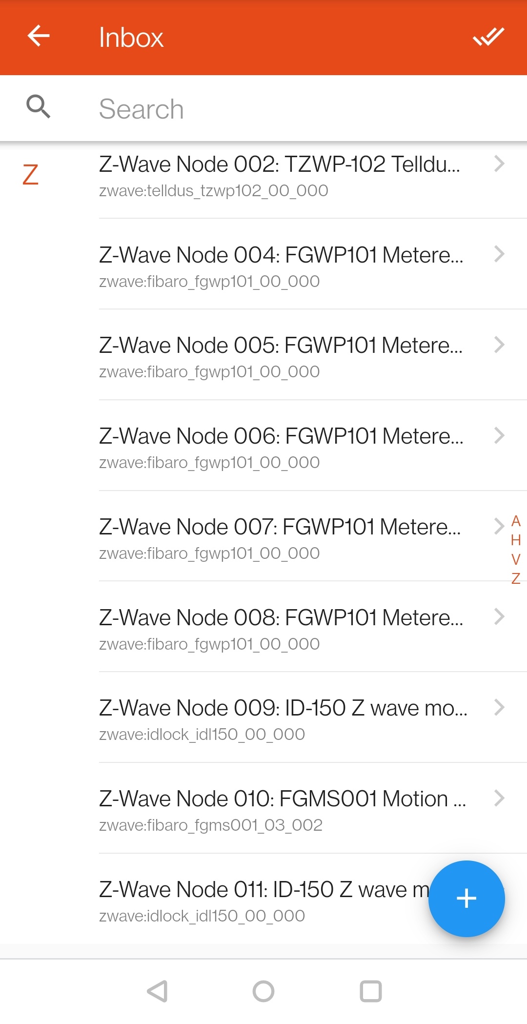

But now the inbox is all the already added zwave devices.
I’ve tried to ignore them. But they seems to keep coming back.

What are the Thing IDs of the newly rediscovered Things?
What is the Thing ID of your ZWave Controller Thing?
You only have the one ZWave Controller Thing, right?
Do your Zwave Things that have already been accepted out of the inbox appear to be ONLINE?
Do they work?
Unfortunately there really wasn’t enough detail to begin with and all we really know about what you’ve done to this point is “a lot of tweaking” so we have no idea what state your OH instance is in nor how it got there. All we can do is make wild guesses as to what might cause the behavior you’ve described.
As the devices are in your z-wave controller’s device table they will continue to show in openhab until you remove them from the controller.
Your zwave USB stick contains a microcontroller and memory that manages the zwave network. OpenHAB is just reading these devices from that microcontroller and memory.
I suggest you do a bit of reading on how zwave works and then I think it will become clear why these devices keep showing. It is only an issue if you have reset the slave devices without first removing them from the zwave network.
