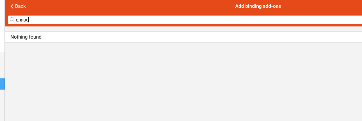

See my edited post above. I couldn’t find it in the UI at all.

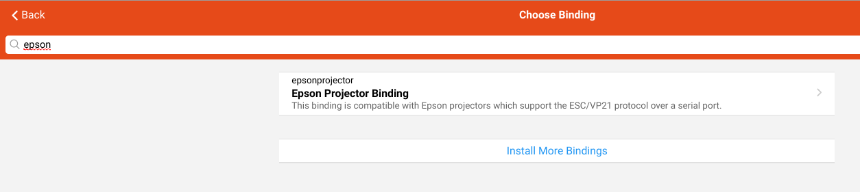

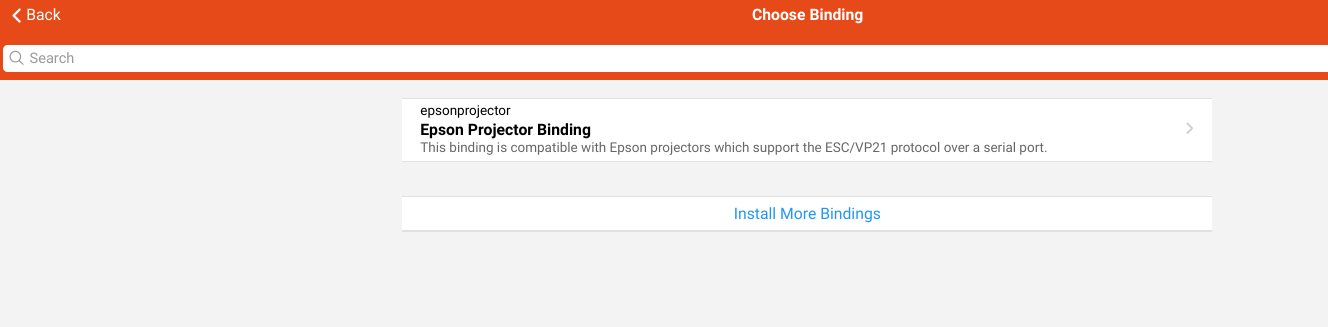

I did install the feature (per the thread I linked to, and as you say too), and actually restarted the whole openHAB. But then I used search and search didn’t return the projector binding:
Though the projector was listed on the non-search page (I just hit search without looking).
I think this was the culprit, a cache of my addons.cfg. And when I removed the line in addons.cfg the cache wasn’t updated.
$ find . -type f | xargs grep epsonprojector
./userdata/config/org/openhab/addons.config:binding="epsonprojector"
Removing that line from that file too, and restarting everything once more, made the binding available and searchable too:

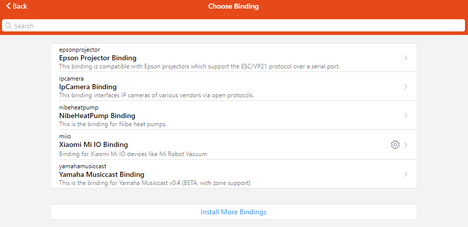

Because those screens you posted are very different.
That’s basically what you can install:
And that’s a list of what’s installed:
