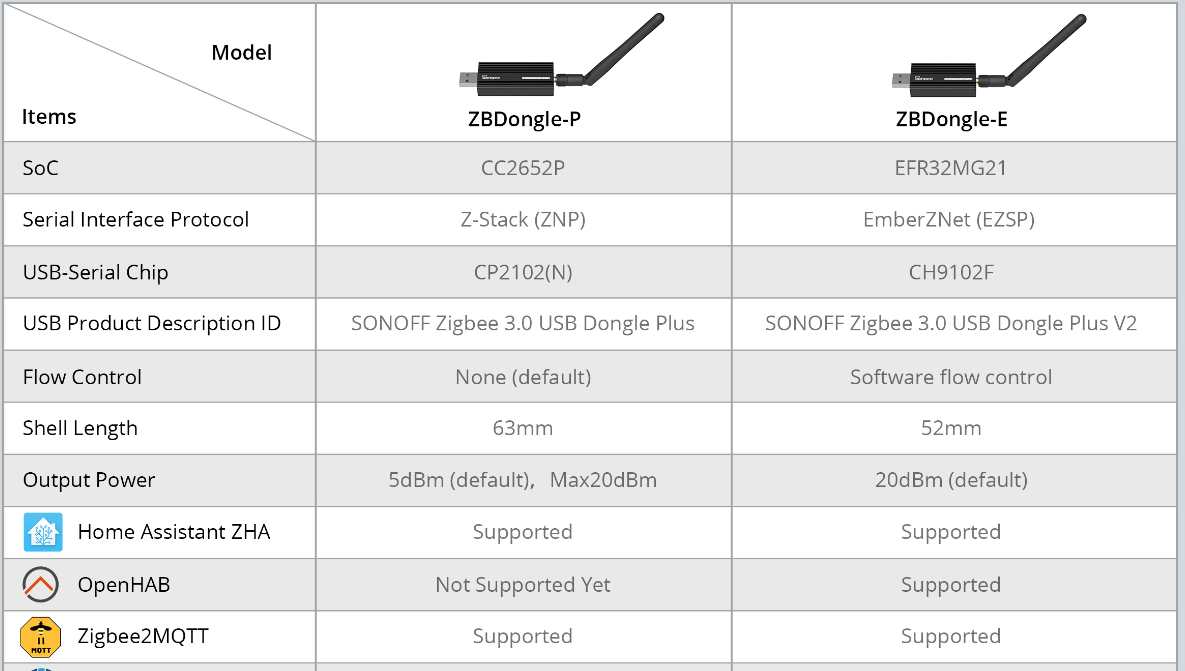

Hi @michaelmell I recently purchased one of these to allow me to remove the need for the Phillips Hue and Ikea Tradfri bridges. So far though I’ve not been able to get it working with openHAB, I’m not sure why though but once you read deeper into the SONOFF documentation there are two versions, one that works and this one. I purchased the ZBDongle-P which seems to be the one most people are selling, where as I need to purchase the ZBDongle-E instead.
If you manage to find someone selling the ZBDongle-E, please put a link here. I for one would be happy to go and purchase one.

Just to confirm: this thread is about zigbee2mqtt (and the MQTT Binding), not using the ZigBee binding in openHAB. I only mention because of

To avoid confusion for anyone coming across this in the future. This thread is about Zigbee2MQTT. As of writing (11. Oct, 2022), the supported controllers page of the Zigbee2MQTT project, lists the P-dongle under recommended:
  • look for SONOFF Zigbee 3.0 USB Dongle Plus ZBDongle-P under recommend section here
whereas the E-dongle is listed under experimental:
  • look for ITead Sonoff Zigbee 3.0 USB Dongle Plus model ZBDongle-E under experimental section here
I write this to avoid confusion, because @Maximo post suggests it is the other way round (though I appreciate your wanting to help(!) :slight_smile: ).

As mentioned and linked in this thread, the E model is classed as having experimental support in zigbee2mqtt, and is not recommended for production setups.
Thanks for letting me know, I cancelled the order and ordered a -P instead
P works fine. I have one.
The E also works, despite what is written in the docs. A colleague of fine just bought one.
But the configuration is a tad different, so there’s that. Iirc the serial adapter is different, see below.
Now, it remains to be seen whether or not it is stable. I would definitely vote for the P.
