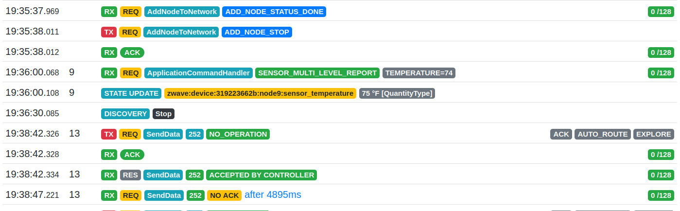

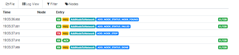

Not a lot to go on. The debug level of a successful inclusion is typically 600KB. There is a log viewer here. What the above shows is this;
. The key being add node status failed.

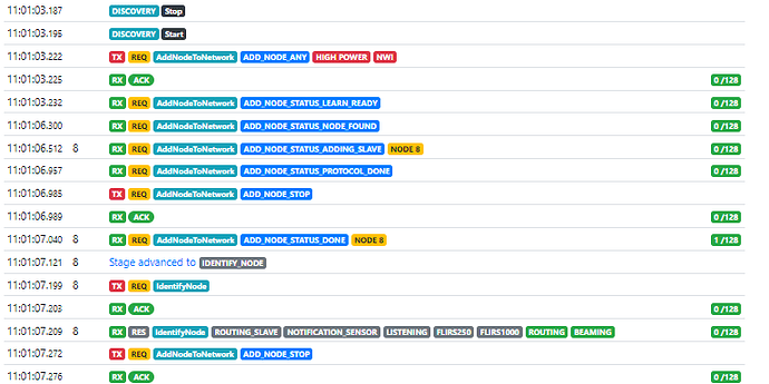

Once the scan is started (Discovery) a successful inclusion looks like this;
Note the added node should show up in yellow. Whatever is failing is happening before the section of the log you posted. EDIT: on closer look it seems the controller (zstick- that mostly handles the communication between the device and the binding) is telling the binding the add node merssage failed. How close is the device to the controller? What type of controller do you have? How and to what is the controller attached to the server running OH? Is it a Rpi?

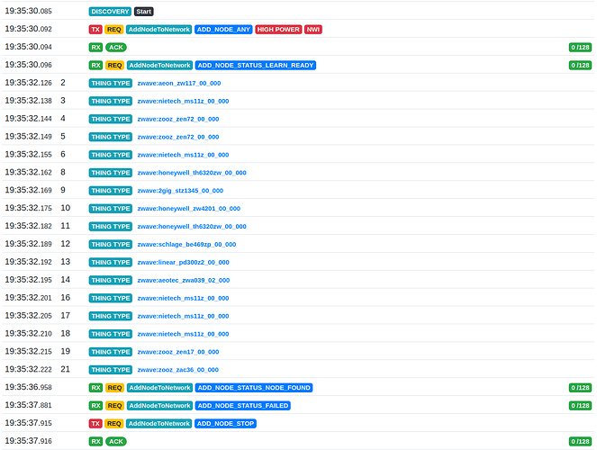

I’ve uploaded my whole log and here is a screenshot of the inclusion.
Interesting enough all my are listed in the inclusion process. Not sure if that is expected. To clarify my statement regarding the device, I think the thermostat is not the problem because it acquired a node id 26 which I can see on its LCD screen. I am using a RaZberry hat on a Rpi 4. Thermostat is 2 floors away from the Rpi, there is another thermostat on the 2nd floor not far from the new thermostat which is working properly.
