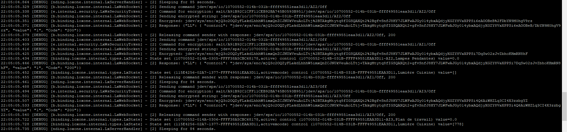

Output of debug for turning on the group through Alexa app:
Nevertheless in reality, only 2 lights are randomly turned on (i.e. not always the same lightes)

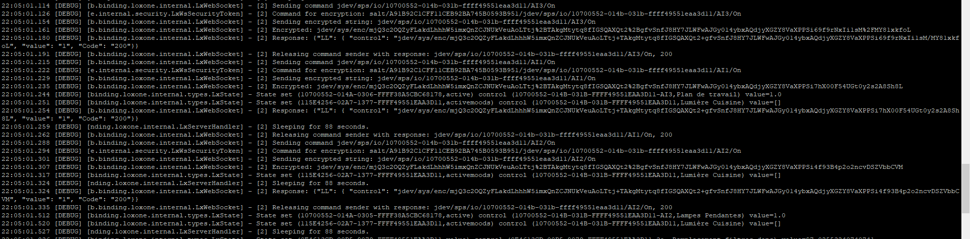

Output when turning off the group:
Again, most of the time, only 2 of the 3 lights turn off…
Thanks for more data. From the logs it looks like all three lights are set to on and each of the three commands is acknowledged by the miniserver. However, Miniserver reports back the status of only two of the changed lights. I suppose this may be some problem in the Miniserver, where the quickly sent commands for multiple outputs of a single lighting controller will not complete all, like there was not queue in the Miniserver for the commands. However, the API spec does not specify that there are any restrictions with sending the commands as long as each command reception is acknowledged by the miniserver and here it is the case. I can think of two solutions. First, report a bug to Loxone. Second, create a workaround in the binding that would artificially delay sending commands to multiple outputs of a lighting controller, as long, as a changed state is not received back from the miniserver. This would be somehow complicated to create and pretty artificial, so I would lean to reporting a bug to Loxone.

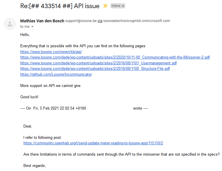

See answer from Loxone:
Not very helpful…
