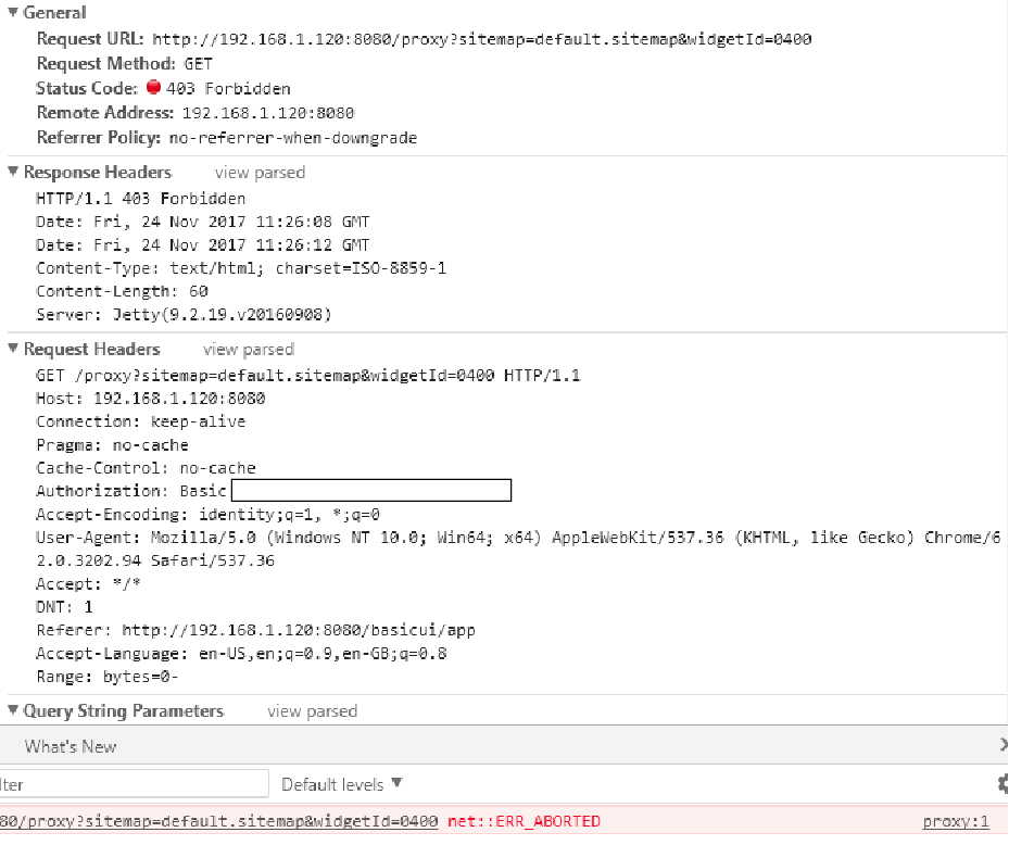

http://user:password@ip/ipcam/stream.cgi?nowprofileid=2andhttp://user:password@ip/video/mjpg.cgiandhttp://user:password@ip/video2.mjpg, since browsers have recently blocked Basic Auth as part of the URL in this format, so none of these worked. Other variations with username and password as query parameters aren’t accepted by the camera (ex.http://ip/ipcam/stream.cgi?user=USERNAME&password=password&nowprofileid=2) -
I then thought to first get it working on Basic UI after seeing HTTP Binding allowing for encoded auth header. However, when using it in an item and putting it on a Sitemap it doesn’t override the URL values of Image, Video or Webview, which it was noted should happen - unless it’s got to do with “some clients may not yet consider item”?

Image/Video/Webview url="https://www.base64encode.org/assets/images/logo.png" item=Network_Device_CameraStream- item doesn’t override Image/Video/Webview urlVideo url="http://192.168.1.112/ipcam/stream.cgi?nowprofileid=2{Authorization=Basic Base64encodedauth}"- Status code 500, Not a valid URIhttp://192.168.1.112/ipcam/stream.cgi?nowprofileid=2{Authorization=Basic Base64encodedauth}- Status Code 403, Request is forbidden (considers it as no auth sent at all)
HTTP Binding version 1.10.0:
timeout - 5000granularity - 1000format - true
No issues showed up in logs, just the browser console responses included above against each attempt.
