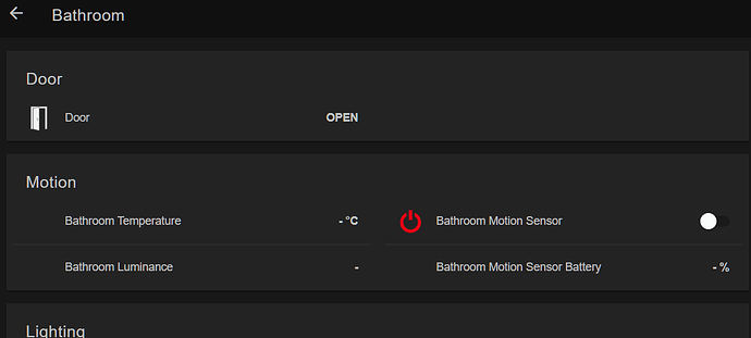

I thought it would be as easy as it was with pairing the other devices, I placed the Philips Hue into pairing mode, hit Scan under the Zigbee binding in OpenHab, it immediately found the device and added it. Then I went into the device and under Channels to get the zigbee channel details which I copied alongside my other working sensors, but no go, everything about it is showing as NULL.

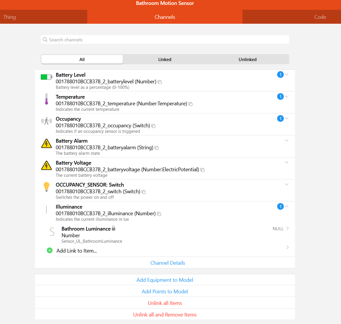

And channel details under the Things page on the OpenHab interface
