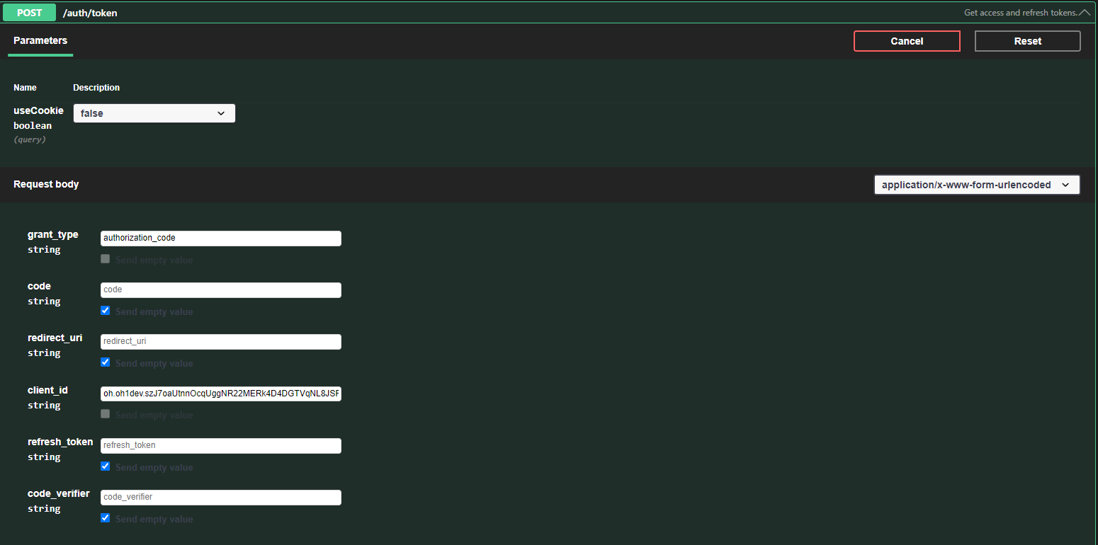

Using the API Explorer in OpenHAB 3.3, the user is presented with the following screen:
It would be impossible to have valid defaults here. Presumably the API Key issued goes into the client_id field, which is our configuration.
There are no hints as to defaults in the remainder of fields, nor a range of options given. Investigation found us a list of options for grant_type:
For a mobile client, either authorization_code or clients_credentials seem valid options, depending on use case.

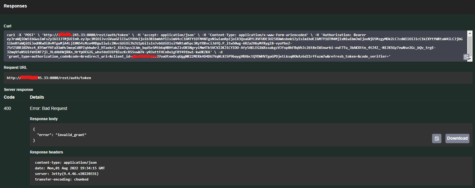

Using the above options alone results in a Response Code 400 with an error of invalid_grant.
But the tool is appending the existing bearer token it’s obtained for itself in an auth header. Thus, it makes sense this would be an invalid grant. So, I remain unconvinced there is actually an issue here.

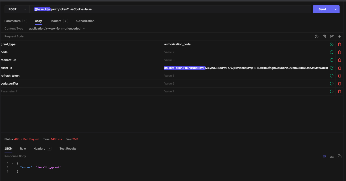

Except, that using e.g. PostMan as a remote test, which should not have a pre-existing token, we achieve the same result.

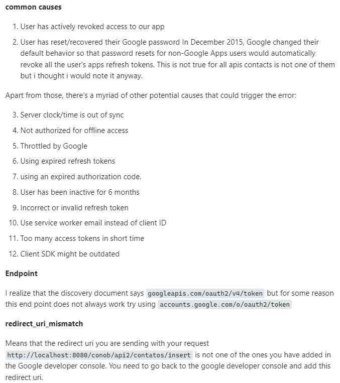

Further investigation into invalid_grant digs up articles that provide a laundry list of issues that can potentially cause this, like this StackOverflow answer:
We installed and validated net time services just to be on the safe side, but the only other option that seems of interest is the redirect URI mismatch.
