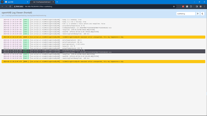

to explain what happens:
heating gradient gets calculated correctly 186 K / 80 min = 2.325 K/min
the substraction 215°C - 215°C = 0°C is somehow right, but it’s not… The result of °C - °C is always K[elvin], even we use it in language different, the difference between 18°C and 19°C is exactly 1 Kelvin.
And in the followup, OH4.1.1 quantity interpretes 0°C correctly as 273.15K and does the operation:
0°C [273.15K] / 2.325 K/min = 117.483870967… min
I don’t know how it did it before, but it worked correctly resulting in 0 min or the intended mins if there is a delta.
I ASSUME it was calculating correctly [°C] - [°C] = [K] or it did a incorrect conversion of 0°C to 0K.
So please correct this or give me a hint, where in github the code is, that does the quantity calculations…
Corrrect is
0°C equals 273.15K
And [°C] - [°C] = [K], where it is decideable if you first calculate and then convert or first convert and then calculate, what I suggest.
And yes, even some may not believe: 215°C - 215°C = 273,15°C… This is correct
In between I will correct my code that it first converts to Kelvin and then starts the calculation, as this will result correctly also
