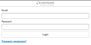

To give a visual of the website I’m interfacing with: upon pressing the “speichern” (Save) button, there’s a redirect to the identical page. Below is an illustrative screenshot:
However, when initiating this POST request from openHAB, I encounter a divergent response:

Based on the fact that you get a login screen when you use the httpPostRequest it looks like the authentication would be missing.
Try to add the referer and the accepted languages in the header.
