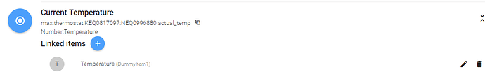

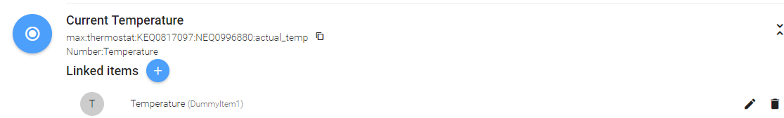

  1. Opened paperui & checked things:

Mystery, everything works this time… yesterday I was using SSH over VPN from my tablet… I wonder if that could have caused any issue.
On the other hand, in paperui, I have several items that I NEVER created in paperui, they were only created via an .items file - why would they show up?
Where in the paperUI ?
Under items.
