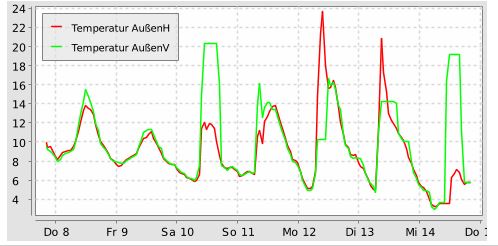

So… your Wemos D1 is sending to your MQTT Broker the messages, you are subscribing to the topics using OH2 Items and you persist their states using rrd4j ? These charts are from an OH2 sitemap element?
If yes: I would start looking at the comms between the D1 and the Broker. Maybe the messages are not being delivered reliably (loss of WiFi signal etc). Check the logs of the Broker for the time period where the OH2 items are not getting state updates.
note: the logs won’t show you the temp values (the mqtt message payload). they will only show you connection info. You may want to increase the log level on the mosquitto broker to catch more info about the connection and publishing attempts.

Yes I am receiving connection lost messages …
Have to search for the reason

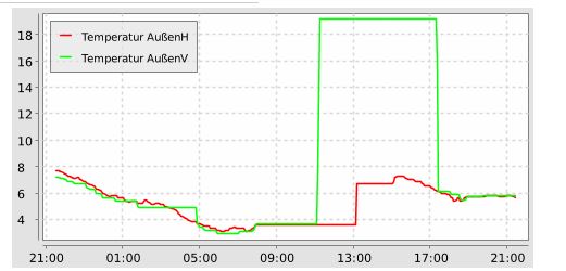

Maybe I was too fast. I am receiving (as expected) connected and disconnected messages, because of the deep sleep. But what I recognized now is that one sensor is not regularly sending its values. Sometimes it does sometimes not.
Do you think the DS18B20 is faulty if it is sending not all the time? Still searching …

I logged today my mqtt traffic and it was quite curious.
in the time I logged it was 108 times status message of the wemos itself (connected,disconnected, connection lost)
but only 29 times /each the values of BMP280 and
only 15 times the DS18B20 temperature.
Maybe you have an idea how or where to look for the issue even if it is ahint for a different forum
The wemos is loosing wifi connection. Could be a number of issues.
I would try swapping the wemos with a new one. There are reports of ESP8266 loosing wifi after a while when the signal is weak
