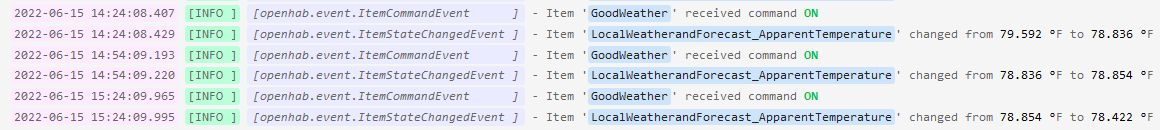

I am using a temperature as a trigger, but I can’t seem to make it work.
In the logs, clearly the temp is above the set point (70 °F) , however the rule never triggers. My guess is that it has something to do with the way temperature is handled, but the topics I’m finding aren’t super helpful. This seems like it should be a quick answer from anyone who knows what they’re doing. Can you help?
