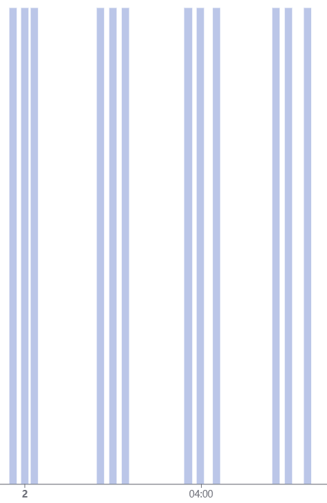

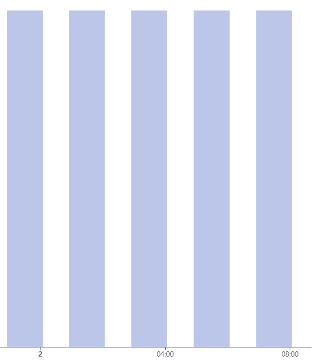

I got an issue with the Zigbee binding using a USB Popp USB-stick. It started after the upgrade to 4.3. Can of course be a coincidence since it also upgrades the PI itself and I reboot it just to be sure.
All devices can be controlled normally but reported every 1 or 2 hours a random state. Think a light said it turned on, while actually stayed off. So only OH thought something changed. Since I got rules and sensors using this states, I performed a downgrade to 4.2.3. This somewhat improved the situation but weird behavior regarding the state remained.
The easy way to reproduce strange things is a light with a switch, color temperature and a dimmer (Lidl light).
Start with color temperature 100, turn on, dimmer to 20. Settings are applied and OH shows them.
Now change the color temperature to 90. Setting is applied but OH changes switch and dimmer to UNDEF.
Now turn on switch. Setting is applied but OH shows ON and dimmer 100 (while it still is using the 20)..
So my best guess: something wrong with reading status and the 2 channels. Something similar happens for color lights.

And for this one the fake update pattern.
