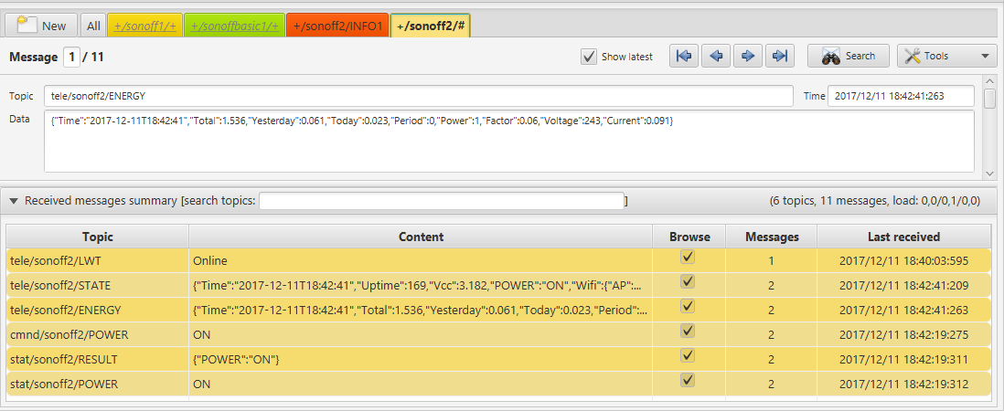

Thanks ThomDietrich, the problem is it seems that there is no message with this topic, i am using mqqt-spy and the topic does not give any message. What i receive you can see in the screenshot. No INFO, NO STATUS messages. I also cannot trigger them or i am missing something here

Have a look at the console window in the SonOff and establish how the correct topics look like. If you are using a localised version then the State topic might read Status (or similar).

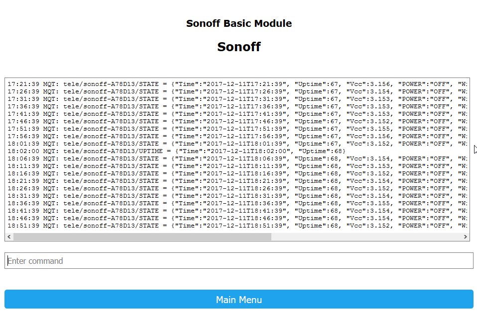

the console gives actually the same as mqtt-spy. Nothing shown as INFO with the current firmware version included which i want to read with the item as stated in the documentations and shown in this threat.

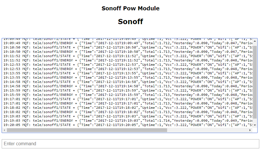

Could you try to get the topic manually shown with a command in that console?
19:43:56 CMD: Status 2
19:43:56 MQT: stat/sonoff_wohnzimmertisch/STATUS2 = {"StatusFWR":{"Version":"5.9.1", "BuildDateTime":"2017-11-16T23:10:27", "Boot":6, "Core":"2_3_0", "SDK":"1.5.3(aec24ac9)"}}
With 5.9.1 Firmware there is a response.
I will do a test for that String in my OH installation.
I just downgraded one POW to make a comparison
There is a response with 5.9.1 and with 5.10.0
19:47:20 CMD: Status 2
19:47:20 MQT: stat/sonoffbasic3/STATUS2 = {"StatusFWR":{"Version":"5.10.0","BuildDateTime":"2017-12-01T13:55:52","Boot":6,"Core":"2_3_0","SDK":"1.5.3(aec24ac9)"}}
19:46:59 CMD: Status 2
19:46:59 MQT: stat/sonoff1/STATUS2 = {"StatusFWR":{"Version":"5.9.1", "BuildDateTime":"2017-11-07T16:23:04", "Boot":31, "Core":"2_3_0", "SDK":"1.5.3(aec24ac9)"}}

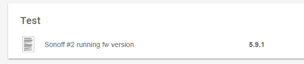

With this setup i get the following result:
Hopefully this will work for you too. :+1:
That absolutely works! Great, thanks so much for your support here, Jerome
