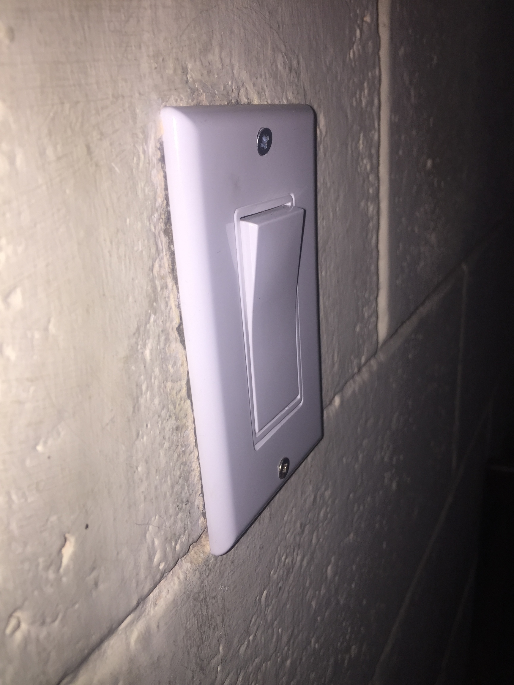

Hey Guys I just made this pedal Wall Switch with a sonoff basic running tasmota, I just configured my MQTT server and its running along with OH2 flawlessly, but i got a problem, when I switch “On” state on my basic UI it turns ON normally, but if i switch OFF the pedal of the Switch I just made, it doesn’t report the state OFF on my Basic UI, so the state its always ON on Open Hab, when the Switch and the light are really OFF. Is it a problem with the state topic?? how can I connect or refresh the state on my basic UI??
heres my MQTT setup
Switch Switch_Entrada “Switch Entrada” {mqtt=">[mosquitto:cmnd/sonoff1/power:command:on:1],>[mosquitto:cmnd/sonoff1/power:command:off:0],<[mosquitto:cmnd/sonoff1/power:state:default]"}
thanks for the help guys

Look on tasmota wiki for switchmode
I got the Switchmode1 4 is the one for fisic switches. When the sonoff its OFF everything its OFF, When I push the botton the relay on the sonoff goes ON and MQTT sends the “ON” stat. Am i missing something??? still can get in my basic UI the switch toggle together with the MQTT
GOT IT!!!
the STATE suscribe topic was wrong in my original Items config.
SOLVED like this
Switch Luz_TV “Luz TV” [ “Lighting” ] {mqtt=">[mosquitto:cmnd/sonoff1/power:command:*:default],<[mosquitto:stat/sonoff1/POWER:state:default]"}
for people having the same problem BEWARE from the “power” topic on the “cmnd” line, and the “POWER” topic on the “stat” line.
Cheers!!
tasmota doesn’t care about capitalisation for incoming topic, Your could send Power, power or POWER, it’s all the same.
BUT tasmota publishers power stat in capitals and openHAB is case sensitive for incoming topics.
For consistency sake ALL my switches use POWER in capitals, both for cmnd and stat topics.
