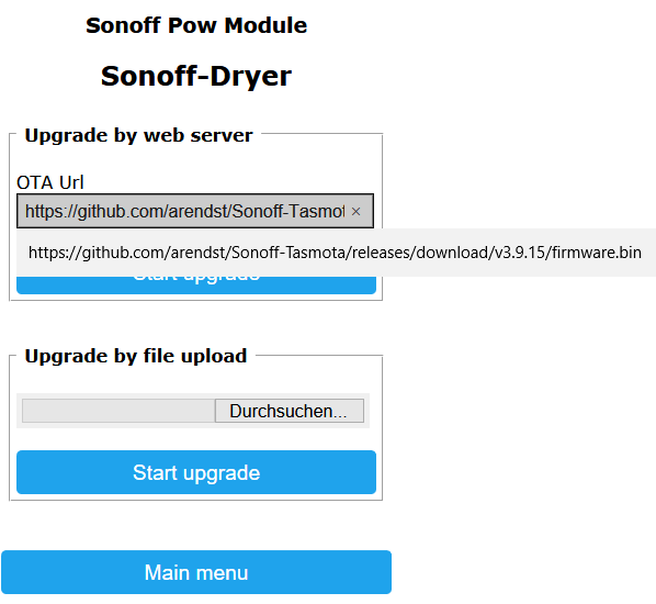

I tried to upload the new Firmware via the OTA-URL:
It said, it would update in a few seconds, but that didn’t happen. After downloading firmware.bin and uploading it in the dialogue it worked. Do you think, this is a bug, or do I miss something?
HTTPS is not supported. You have to download the file first, then upload as file.
