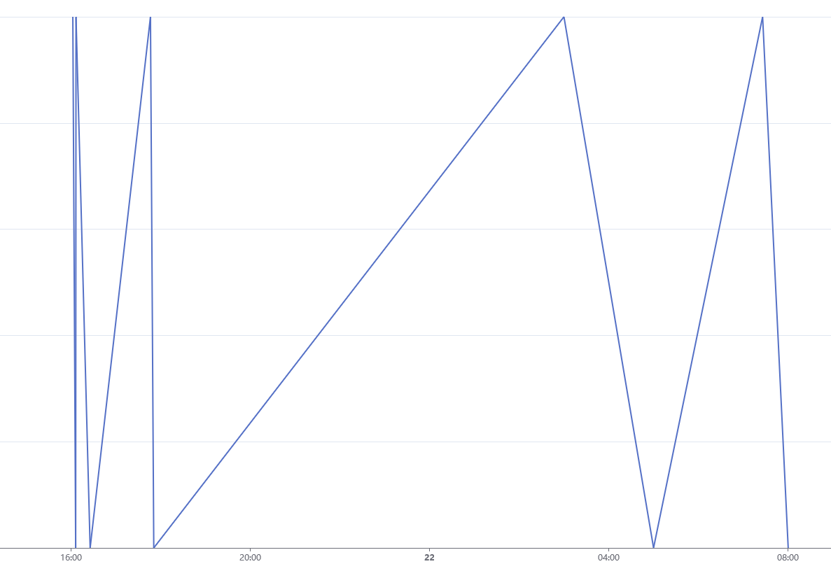

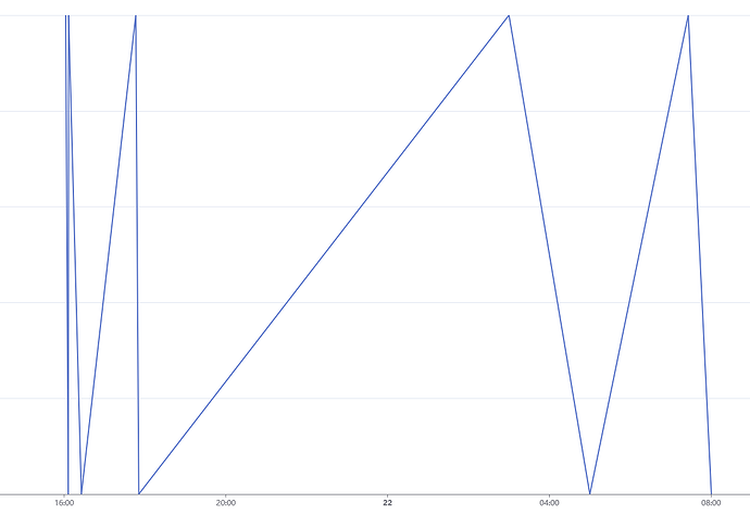

Here is the log from last night:
023-06-22 02:00:00.081 [INFO ] [nhab.automation.script.ui.2f5869435c] - influx.js: Getting the current value for nibe_control...
2023-06-22 02:00:00.121 [INFO ] [nhab.automation.script.ui.3182dbd7b9] - influx.js: Getting the current value for washer_control...
2023-06-22 02:00:00.130 [INFO ] [nhab.automation.script.ui.2f5869435c] - influx.js: Current nibe_control is 0
2023-06-22 02:00:00.134 [INFO ] [nhab.automation.script.ui.2f5869435c] - Heat pump compressor: No state change needed.
2023-06-22 02:00:00.173 [INFO ] [nhab.automation.script.ui.3182dbd7b9] - influx.js: Current washer_control is 0
2023-06-22 02:00:00.174 [INFO ] [nhab.automation.script.ui.3182dbd7b9] - Washer: No state change needed.
2023-06-22 02:00:00.601 [INFO ] [nhab.automation.script.ui.722b404955] - influx.js: Getting the current value for dishwasher_control...
2023-06-22 02:00:00.634 [INFO ] [nhab.automation.script.ui.70e8e77f5c] - influx.js: Getting the current value for spot_price...
2023-06-22 02:00:00.648 [INFO ] [nhab.automation.script.ui.722b404955] - influx.js: Current dishwasher_control is 0
2023-06-22 02:00:00.649 [INFO ] [nhab.automation.script.ui.722b404955] - Tiskikoneen ohjaus: 0
2023-06-22 02:00:00.654 [INFO ] [nhab.automation.script.ui.722b404955] - influx.js: Getting the current value for washer_control...
2023-06-22 02:00:00.675 [INFO ] [nhab.automation.script.ui.b2e14a2c5f] - influx.js: Getting the current value for drier_control...
2023-06-22 02:00:00.704 [INFO ] [nhab.automation.script.ui.70e8e77f5c] - influx.js: Current spot_price is 5.6184400000000005
2023-06-22 02:00:00.718 [INFO ] [nhab.automation.script.ui.722b404955] - influx.js: Current washer_control is 0
2023-06-22 02:00:00.719 [INFO ] [nhab.automation.script.ui.722b404955] - Pesukoneen ohjaus: 0
2023-06-22 02:00:00.758 [INFO ] [nhab.automation.script.ui.b2e14a2c5f] - influx.js: Current drier_control is 1
2023-06-22 02:00:00.763 [INFO ] [nhab.automation.script.ui.b2e14a2c5f] - Drier ON.
2023-06-22 03:00:00.075 [INFO ] [nhab.automation.script.ui.2f5869435c] - influx.js: Getting the current value for nibe_control...
2023-06-22 03:00:00.121 [INFO ] [nhab.automation.script.ui.2f5869435c] - influx.js: Current nibe_control is 0
2023-06-22 03:00:00.121 [INFO ] [nhab.automation.script.ui.3182dbd7b9] - influx.js: Getting the current value for washer_control...
2023-06-22 03:00:00.125 [INFO ] [nhab.automation.script.ui.2f5869435c] - Heat pump compressor: No state change needed.
2023-06-22 03:00:00.164 [INFO ] [nhab.automation.script.ui.3182dbd7b9] - influx.js: Current washer_control is 1
2023-06-22 03:00:00.601 [INFO ] [nhab.automation.script.ui.722b404955] - influx.js: Getting the current value for dishwasher_control...
2023-06-22 03:00:00.633 [INFO ] [nhab.automation.script.ui.70e8e77f5c] - influx.js: Getting the current value for spot_price...
2023-06-22 03:00:00.654 [INFO ] [nhab.automation.script.ui.722b404955] - influx.js: Current dishwasher_control is 1
2023-06-22 03:00:00.656 [INFO ] [nhab.automation.script.ui.722b404955] - Tiskikoneen ohjaus: 1
2023-06-22 03:00:00.658 [INFO ] [nhab.automation.script.ui.722b404955] - influx.js: Getting the current value for washer_control...
2023-06-22 03:00:00.674 [INFO ] [nhab.automation.script.ui.b2e14a2c5f] - influx.js: Getting the current value for drier_control...
2023-06-22 03:00:00.703 [INFO ] [nhab.automation.script.ui.70e8e77f5c] - influx.js: Current spot_price is 5.1398
2023-06-22 03:00:00.707 [INFO ] [nhab.automation.script.ui.722b404955] - influx.js: Current washer_control is 1
2023-06-22 03:00:00.709 [INFO ] [nhab.automation.script.ui.722b404955] - Pesukoneen ohjaus: 1
2023-06-22 03:00:00.752 [INFO ] [nhab.automation.script.ui.b2e14a2c5f] - influx.js: Current drier_control is 1
2023-06-22 03:00:00.754 [INFO ] [nhab.automation.script.ui.b2e14a2c5f] - Drier: No state change needed.
2023-06-22 03:00:00.763 [INFO ] [nhab.automation.script.ui.3182dbd7b9] - Washer: Started.
2023-06-22 04:00:00.081 [INFO ] [nhab.automation.script.ui.2f5869435c] - influx.js: Getting the current value for nibe_control...
2023-06-22 04:00:00.120 [INFO ] [nhab.automation.script.ui.3182dbd7b9] - influx.js: Getting the current value for washer_control...
2023-06-22 04:00:00.133 [INFO ] [nhab.automation.script.ui.2f5869435c] - influx.js: Current nibe_control is 0
2023-06-22 04:00:00.136 [INFO ] [nhab.automation.script.ui.2f5869435c] - Heat pump compressor: No state change needed.
2023-06-22 04:00:00.172 [INFO ] [nhab.automation.script.ui.3182dbd7b9] - influx.js: Current washer_control is 1
2023-06-22 04:00:00.602 [INFO ] [nhab.automation.script.ui.722b404955] - influx.js: Getting the current value for dishwasher_control...
2023-06-22 04:00:00.603 [INFO ] [nhab.automation.script.ui.3182dbd7b9] - Washer: Started.
2023-06-22 04:00:00.633 [INFO ] [nhab.automation.script.ui.70e8e77f5c] - influx.js: Getting the current value for spot_price...
2023-06-22 04:00:00.648 [INFO ] [nhab.automation.script.ui.722b404955] - influx.js: Current dishwasher_control is 1
2023-06-22 04:00:00.649 [INFO ] [nhab.automation.script.ui.722b404955] - Tiskikoneen ohjaus: 1
2023-06-22 04:00:00.652 [INFO ] [nhab.automation.script.ui.722b404955] - influx.js: Getting the current value for washer_control...
2023-06-22 04:00:00.674 [INFO ] [nhab.automation.script.ui.b2e14a2c5f] - influx.js: Getting the current value for drier_control...
2023-06-22 04:00:00.751 [INFO ] [nhab.automation.script.ui.722b404955] - influx.js: Current washer_control is 1
2023-06-22 04:00:00.753 [INFO ] [nhab.automation.script.ui.722b404955] - Pesukoneen ohjaus: 1
2023-06-22 04:00:00.762 [INFO ] [nhab.automation.script.ui.70e8e77f5c] - influx.js: Current spot_price is 5.09268
2023-06-22 04:00:00.836 [INFO ] [nhab.automation.script.ui.b2e14a2c5f] - influx.js: Current drier_control is 1
2023-06-22 04:00:00.838 [INFO ] [nhab.automation.script.ui.b2e14a2c5f] - Drier: No state change needed.
2023-06-22 05:00:00.076 [INFO ] [nhab.automation.script.ui.2f5869435c] - influx.js: Getting the current value for nibe_control...
2023-06-22 05:00:00.122 [INFO ] [nhab.automation.script.ui.3182dbd7b9] - influx.js: Getting the current value for washer_control...
2023-06-22 05:00:00.123 [INFO ] [nhab.automation.script.ui.2f5869435c] - influx.js: Current nibe_control is 0
2023-06-22 05:00:00.167 [INFO ] [nhab.automation.script.ui.3182dbd7b9] - influx.js: Current washer_control is 0
2023-06-22 05:00:00.168 [INFO ] [nhab.automation.script.ui.3182dbd7b9] - Washer: No state change needed.
2023-06-22 05:00:00.600 [INFO ] [nhab.automation.script.ui.722b404955] - influx.js: Getting the current value for dishwasher_control...
2023-06-22 05:00:00.634 [INFO ] [nhab.automation.script.ui.70e8e77f5c] - influx.js: Getting the current value for spot_price...
2023-06-22 05:00:00.659 [INFO ] [nhab.automation.script.ui.722b404955] - influx.js: Current dishwasher_control is 0
2023-06-22 05:00:00.662 [INFO ] [nhab.automation.script.ui.722b404955] - Tiskikoneen ohjaus: 0
2023-06-22 05:00:00.664 [INFO ] [nhab.automation.script.ui.722b404955] - influx.js: Getting the current value for washer_control...
2023-06-22 05:00:00.674 [INFO ] [nhab.automation.script.ui.b2e14a2c5f] - influx.js: Getting the current value for drier_control...
2023-06-22 05:00:00.702 [INFO ] [nhab.automation.script.ui.70e8e77f5c] - influx.js: Current spot_price is 5.6234
2023-06-22 05:00:00.731 [INFO ] [nhab.automation.script.ui.b2e14a2c5f] - influx.js: Current drier_control is 1
2023-06-22 05:00:00.734 [INFO ] [nhab.automation.script.ui.b2e14a2c5f] - Drier: No state change needed.
2023-06-22 05:00:00.765 [INFO ] [nhab.automation.script.ui.722b404955] - influx.js: Current washer_control is 0
2023-06-22 05:00:00.767 [INFO ] [nhab.automation.script.ui.722b404955] - Pesukoneen ohjaus: 0
2023-06-22 06:00:00.080 [INFO ] [nhab.automation.script.ui.2f5869435c] - influx.js: Getting the current value for nibe_control...
2023-06-22 06:00:00.120 [INFO ] [nhab.automation.script.ui.3182dbd7b9] - influx.js: Getting the current value for washer_control...
2023-06-22 06:00:00.127 [INFO ] [nhab.automation.script.ui.2f5869435c] - influx.js: Current nibe_control is 0
2023-06-22 06:00:00.130 [INFO ] [nhab.automation.script.ui.2f5869435c] - Heat pump compressor: No state change needed.
2023-06-22 06:00:00.167 [INFO ] [nhab.automation.script.ui.3182dbd7b9] - influx.js: Current washer_control is 0
2023-06-22 06:00:00.168 [INFO ] [nhab.automation.script.ui.3182dbd7b9] - Washer: No state change needed.
2023-06-22 06:00:00.601 [INFO ] [nhab.automation.script.ui.722b404955] - influx.js: Getting the current value for dishwasher_control...
2023-06-22 06:00:00.634 [INFO ] [nhab.automation.script.ui.70e8e77f5c] - influx.js: Getting the current value for spot_price...
2023-06-22 06:00:00.655 [INFO ] [nhab.automation.script.ui.722b404955] - influx.js: Current dishwasher_control is 0
2023-06-22 06:00:00.657 [INFO ] [nhab.automation.script.ui.722b404955] - Tiskikoneen ohjaus: 0
2023-06-22 06:00:00.660 [INFO ] [nhab.automation.script.ui.722b404955] - influx.js: Getting the current value for washer_control...
2023-06-22 06:00:00.674 [INFO ] [nhab.automation.script.ui.b2e14a2c5f] - influx.js: Getting the current value for drier_control...
2023-06-22 06:00:00.684 [INFO ] [nhab.automation.script.ui.70e8e77f5c] - influx.js: Current spot_price is 6.18264
2023-06-22 06:00:00.712 [INFO ] [nhab.automation.script.ui.722b404955] - influx.js: Current washer_control is 0
2023-06-22 06:00:00.714 [INFO ] [nhab.automation.script.ui.722b404955] - Pesukoneen ohjaus: 0
2023-06-22 06:00:00.725 [INFO ] [nhab.automation.script.ui.b2e14a2c5f] - influx.js: Current drier_control is 0
2023-06-22 06:00:00.728 [INFO ] [nhab.automation.script.ui.b2e14a2c5f] - Drier OFF.
It is of the type Number.
When not running it is “inactive”. Did not check what it was at 4 in the morning, though.
I think it does so, at least judging from the logs.
The openhab.log is posted above, where the item states may be available.
Events log:
023-06-22 03:00:00.167 [INFO ] [openhab.event.ItemCommandEvent      ] - Item 'Pesukoneen_virtakatkaisija_Pesukoneen_virtakytkin' received command ON
2023-06-22 03:00:00.179 [INFO ] [penhab.event.ItemStatePredictedEvent] - Item 'Pesukoneen_virtakatkaisija_Pesukoneen_virtakytkin' predicted to become ON
2023-06-22 03:00:00.188 [INFO ] [openhab.event.ItemStateChangedEvent ] - Item 'Pesukoneen_virtakatkaisija_Pesukoneen_virtakytkin' changed from OFF to ON
2023-06-22 03:00:00.567 [INFO ] [openhab.event.ItemCommandEvent      ] - Item 'Pesukoneen_ohjelmanappi_pesukoneenOhjelmaNappi' received command ON
2023-06-22 03:00:00.576 [INFO ] [penhab.event.ItemStatePredictedEvent] - Item 'Pesukoneen_ohjelmanappi_pesukoneenOhjelmaNappi' predicted to become OFF
2023-06-22 03:00:00.661 [INFO ] [openhab.event.ItemStateChangedEvent ] - Item 'dishwasherControl' changed from 0.0 to 1.0
2023-06-22 03:00:00.709 [INFO ] [openhab.event.ItemStateChangedEvent ] - Item 'sahkonHinta' changed from 5.6184400000000005 to 5.1398
2023-06-22 03:00:00.714 [INFO ] [openhab.event.ItemStateChangedEvent ] - Item 'washerControl' changed from 0.0 to 1.0
2023-06-22 03:00:00.891 [INFO ] [openhab.event.ItemCommandEvent      ] - Item 'Pesukoneen_virtakatkaisija_Pesukoneen_virtakytkin' received command OFF
2023-06-22 03:00:00.899 [INFO ] [penhab.event.ItemStatePredictedEvent] - Item 'Pesukoneen_virtakatkaisija_Pesukoneen_virtakytkin' predicted to become OFF
2023-06-22 03:00:00.903 [INFO ] [openhab.event.ItemStateChangedEvent ] - Item 'Pesukoneen_virtakatkaisija_Pesukoneen_virtakytkin' changed from ON to OFF
2023-06-22 03:00:01.271 [INFO ] [openhab.event.ItemCommandEvent      ] - Item 'Pesukoneen_ohjelmanappi_pesukoneenOhjelmaNappi' received command OFF
2023-06-22 03:00:01.273 [INFO ] [penhab.event.ItemStatePredictedEvent] - Item 'Pesukoneen_ohjelmanappi_pesukoneenOhjelmaNappi' predicted to become OFF
2023-06-22 03:00:04.988 [INFO ] [openhab.event.ItemStateChangedEvent ] - Item 'Takan_Zigbee_anturi_Takka' changed from 22.6 °C to 22.5 °C
2023-06-22 03:00:04.991 [INFO ] [hab.event.GroupItemStateChangedEvent] - Item 'Olohuone' changed from 225 °C to 22.5 °C through Takan_Zigbee_anturi_Takka
2023-06-22 03:00:24.486 [INFO ] [openhab.event.ItemStateChangedEvent ] - Item 'MIinan_huoneen_Zigbee_sensori_Miinan_huoneen_lampotila' changed from 21.6 °C to 21.3 °C
2023-06-22 03:00:33.941 [INFO ] [openhab.event.ItemStateChangedEvent ] - Item 'Autotallin_Zigbeeanturi_Autotallin_Lampotilaanturi' changed from 21.4 °C to 21.3 °C
2023-06-22 03:04:00.001 [INFO ] [openhab.event.ChannelTriggeredEvent ] - astro:sun:local:rise#event triggered START
2023-06-22 03:10:04.901 [INFO ] [hab.event.GroupItemStateChangedEvent] - Item 'Olohuone' changed from 225 °C to 22.5 °C through Takan_Zigbee_anturi_Takka
2023-06-22 03:10:09.696 [INFO ] [openhab.event.ItemStateChangedEvent ] - Item 'aulanZigbeeAnturi' changed from 21.8 °C to 21.6 °C
2023-06-22 03:10:14.881 [INFO ] [openhab.event.ItemStateChangedEvent ] - Item 'TerassinZigbeeLampoAnturi' changed from 14.4 °C to 14.1 °C
2023-06-22 03:17:00.001 [INFO ] [openhab.event.ChannelTriggeredEvent ] - astro:sun:local:daylight#event triggered START
2023-06-22 03:17:00.002 [INFO ] [openhab.event.ChannelTriggeredEvent ] - astro:sun:local:rise#event triggered END
2023-06-22 03:20:05.342 [INFO ] [hab.event.GroupItemStateChangedEvent] - Item 'Olohuone' changed from 225 °C to 22.5 °C through Takan_Zigbee_anturi_Takka
2023-06-22 03:20:19.722 [INFO ] [openhab.event.ItemStateChangedEvent ] - Item 'aaroninHuoneenAnturi' changed from 23.7 °C to 23.6 °C
2023-06-22 03:20:19.725 [INFO ] [hab.event.GroupItemStateChangedEvent] - Item 'aaroninMakuuhuone' changed from 23.7 °C to 23.6 °C through aaroninHuoneenAnturi
2023-06-22 03:20:39.623 [INFO ] [openhab.event.ItemStateChangedEvent ] - Item 'radioHuoneenLampotilaMqtt' changed from 22.8 °C to 22.7 °C
2023-06-22 03:30:04.907 [INFO ] [openhab.event.ItemStateChangedEvent ] - Item 'Takan_Zigbee_anturi_Takka' changed from 22.5 °C to 22.3 °C
2023-06-22 03:30:04.911 [INFO ] [hab.event.GroupItemStateChangedEvent] - Item 'Olohuone' changed from 223 °C to 22.3 °C through Takan_Zigbee_anturi_Takka
2023-06-22 03:30:23.836 [INFO ] [openhab.event.ItemStateChangedEvent ] - Item 'MIinan_huoneen_Zigbee_sensori_Miinan_huoneen_lampotila' changed from 21.3 °C to 21.1 °C
2023-06-22 03:30:33.943 [INFO ] [openhab.event.ItemStateChangedEvent ] - Item 'Autotallin_Zigbeeanturi_Autotallin_Lampotilaanturi' changed from 21.3 °C to 21.2 °C
2023-06-22 03:40:04.912 [INFO ] [hab.event.GroupItemStateChangedEvent] - Item 'Olohuone' changed from 223 °C to 22.3 °C through Takan_Zigbee_anturi_Takka
2023-06-22 03:40:09.663 [INFO ] [openhab.event.ItemStateChangedEvent ] - Item 'aulanZigbeeAnturi' changed from 21.6 °C to 21.4 °C
2023-06-22 03:40:14.400 [INFO ] [openhab.event.ItemStateChangedEvent ] - Item 'TerassinZigbeeLampoAnturi' changed from 14.1 °C to 13.6 °C
2023-06-22 03:40:29.129 [INFO ] [openhab.event.ItemStateChangedEvent ] - Item 'ZigbeeSensori' changed from 24.6 °C to 24.5 °C
2023-06-22 03:50:04.927 [INFO ] [hab.event.GroupItemStateChangedEvent] - Item 'Olohuone' changed from 223 °C to 22.3 °C through Takan_Zigbee_anturi_Takka
2023-06-22 03:50:19.736 [INFO ] [openhab.event.ItemStateChangedEvent ] - Item 'aaroninHuoneenAnturi' changed from 23.6 °C to 23.4 °C
2023-06-22 03:50:19.739 [INFO ] [hab.event.GroupItemStateChangedEvent] - Item 'aaroninMakuuhuone' changed from 23.6 °C to 23.4 °C through aaroninHuoneenAnturi
2023-06-22 03:50:38.742 [INFO ] [openhab.event.ItemStateChangedEvent ] - Item 'radioHuoneenLampotilaMqtt' changed from 22.7 °C to 22.6 °C
2023-06-22 04:00:00.175 [INFO ] [openhab.event.ItemCommandEvent      ] - Item 'Pesukoneen_virtakatkaisija_Pesukoneen_virtakytkin' received command ON
2023-06-22 04:00:00.187 [INFO ] [penhab.event.ItemStatePredictedEvent] - Item 'Pesukoneen_virtakatkaisija_Pesukoneen_virtakytkin' predicted to become ON
2023-06-22 04:00:00.199 [INFO ] [openhab.event.ItemStateChangedEvent ] - Item 'Pesukoneen_virtakatkaisija_Pesukoneen_virtakytkin' changed from OFF to ON
2023-06-22 04:00:00.425 [INFO ] [openhab.event.ItemCommandEvent      ] - Item 'Pesukoneen_ohjelmanappi_pesukoneenOhjelmaNappi' received command ON
2023-06-22 04:00:00.436 [INFO ] [penhab.event.ItemStatePredictedEvent] - Item 'Pesukoneen_ohjelmanappi_pesukoneenOhjelmaNappi' predicted to become OFF
2023-06-22 04:00:00.774 [INFO ] [openhab.event.ItemStateChangedEvent ] - Item 'sahkonHinta' changed from 5.1398 to 5.09268
2023-06-22 04:00:00.882 [INFO ] [openhab.event.ItemCommandEvent      ] - Item 'Pesukoneen_virtakatkaisija_Pesukoneen_virtakytkin' received command OFF
2023-06-22 04:00:00.891 [INFO ] [penhab.event.ItemStatePredictedEvent] - Item 'Pesukoneen_virtakatkaisija_Pesukoneen_virtakytkin' predicted to become OFF
2023-06-22 04:00:00.895 [INFO ] [openhab.event.ItemStateChangedEvent ] - Item 'Pesukoneen_virtakatkaisija_Pesukoneen_virtakytkin' changed from ON to OFF
2023-06-22 04:00:01.107 [INFO ] [openhab.event.ItemCommandEvent      ] - Item 'Pesukoneen_ohjelmanappi_pesukoneenOhjelmaNappi' received command OFF
2023-06-22 04:00:01.119 [INFO ] [penhab.event.ItemStatePredictedEvent] - Item 'Pesukoneen_ohjelmanappi_pesukoneenOhjelmaNappi' predicted to become OFF
2023-06-22 04:00:05.527 [INFO ] [hab.event.GroupItemStateChangedEvent] - Item 'Olohuone' changed from 222 °C to 22.2 °C through Takan_Zigbee_anturi_Takka
2023-06-22 04:00:05.528 [INFO ] [openhab.event.ItemStateChangedEvent ] - Item 'Takan_Zigbee_anturi_Takka' changed from 22.3 °C to 22.2 °C
2023-06-22 04:00:24.572 [INFO ] [openhab.event.ItemStateChangedEvent ] - Item 'MIinan_huoneen_Zigbee_sensori_Miinan_huoneen_lampotila' changed from 21.1 °C to 20.8 °C
2023-06-22 04:10:04.954 [INFO ] [hab.event.GroupItemStateChangedEvent] - Item 'Olohuone' changed from 222 °C to 22.2 °C through Takan_Zigbee_anturi_Takka
2023-06-22 04:10:09.719 [INFO ] [openhab.event.ItemStateChangedEvent ] - Item 'aulanZigbeeAnturi' changed from 21.4 °C to 21.2 °C
2023-06-22 04:10:14.446 [INFO ] [openhab.event.ItemStateChangedEvent ] - Item 'TerassinZigbeeLampoAnturi' changed from 13.6 °C to 13.3 °C
2023-06-22 04:10:28.802 [INFO ] [openhab.event.ItemStateChangedEvent ] - Item 'ZigbeeSensori' changed from 24.5 °C to 24.4 °C
2023-06-22 04:18:53.379 [INFO ] [openhab.event.ItemStateChangedEvent ] - Item 'Aurinko_Sateily_yhteensa' changed from 0 W/m² to 20.708617506597598 W/m²
2023-06-22 04:20:04.936 [INFO ] [hab.event.GroupItemStateChangedEvent] - Item 'Olohuone' changed from 222 °C to 22.2 °C through Takan_Zigbee_anturi_Takka
2023-06-22 04:20:19.271 [INFO ] [openhab.event.ItemStateChangedEvent ] - Item 'aaroninHuoneenAnturi' changed from 23.4 °C to 23.2 °C
2023-06-22 04:20:19.274 [INFO ] [hab.event.GroupItemStateChangedEvent] - Item 'aaroninMakuuhuone' changed from 23.4 °C to 23.2 °C through aaroninHuoneenAnturi
2023-06-22 04:23:53.377 [INFO ] [openhab.event.ItemStateChangedEvent ] - Item 'Aurinko_Sateily_yhteensa' changed from 20.708617506597598 W/m² to 22.891902273835065 W/m²
2023-06-22 04:28:53.379 [INFO ] [openhab.event.ItemStateChangedEvent ] - Item 'Aurinko_Sateily_yhteensa' changed from 22.891902273835065 W/m² to 25.143183248021963 W/m²
2023-06-22 04:30:04.923 [INFO ] [openhab.event.ItemStateChangedEvent ] - Item 'Takan_Zigbee_anturi_Takka' changed from 22.2 °C to 22.1 °C
2023-06-22 04:30:04.927 [INFO ] [hab.event.GroupItemStateChangedEvent] - Item 'Olohuone' changed from 221 °C to 22.1 °C through Takan_Zigbee_anturi_Takka
2023-06-22 04:30:24.438 [INFO ] [openhab.event.ItemStateChangedEvent ] - Item 'MIinan_huoneen_Zigbee_sensori_Miinan_huoneen_lampotila' changed from 20.8 °C to 20.6 °C
2023-06-22 04:30:34.030 [INFO ] [openhab.event.ItemStateChangedEvent ] - Item 'Autotallin_Zigbeeanturi_Autotallin_Lampotilaanturi' changed from 21.2 °C to 21.1 °C
2023-06-22 04:33:53.379 [INFO ] [openhab.event.ItemStateChangedEvent ] - Item 'Aurinko_Sateily_yhteensa' changed from 25.143183248021963 W/m² to 27.468845665925524 W/m²
2023-06-22 04:38:53.379 [INFO ] [openhab.event.ItemStateChangedEvent ] - Item 'Aurinko_Sateily_yhteensa' changed from 27.468845665925524 W/m² to 29.876697520343455 W/m²
2023-06-22 04:40:05.414 [INFO ] [hab.event.GroupItemStateChangedEvent] - Item 'Olohuone' changed from 221 °C to 22.1 °C through Takan_Zigbee_anturi_Takka
2023-06-22 04:40:10.593 [INFO ] [openhab.event.ItemStateChangedEvent ] - Item 'aulanZigbeeAnturi' changed from 21.2 °C to 21 °C
2023-06-22 04:40:15.493 [INFO ] [openhab.event.ItemStateChangedEvent ] - Item 'TerassinZigbeeLampoAnturi' changed from 13.3 °C to 13.1 °C
2023-06-22 04:43:53.377 [INFO ] [openhab.event.ItemStateChangedEvent ] - Item 'Aurinko_Sateily_yhteensa' changed from 29.876697520343455 W/m² to 32.3757486446299 W/m²
2023-06-22 04:48:53.377 [INFO ] [openhab.event.ItemStateChangedEvent ] - Item 'Aurinko_Sateily_yhteensa' changed from 32.3757486446299 W/m² to 34.97602548834719 W/m²
2023-06-22 04:50:04.938 [INFO ] [hab.event.GroupItemStateChangedEvent] - Item 'Olohuone' changed from 221 °C to 22.1 °C through Takan_Zigbee_anturi_Takka
2023-06-22 04:50:19.277 [INFO ] [openhab.event.ItemStateChangedEvent ] - Item 'aaroninHuoneenAnturi' changed from 23.2 °C to 23 °C
2023-06-22 04:50:19.281 [INFO ] [hab.event.GroupItemStateChangedEvent] - Item 'aaroninMakuuhuone' changed from 23.2 °C to 23 °C through aaroninHuoneenAnturi
2023-06-22 04:50:38.793 [INFO ] [openhab.event.ItemStateChangedEvent ] - Item 'radioHuoneenLampotilaMqtt' changed from 22.6 °C to 22.5 °C
2023-06-22 04:53:53.377 [INFO ] [openhab.event.ItemStateChangedEvent ] - Item 'Aurinko_Sateily_yhteensa' changed from 34.97602548834719 W/m² to 37.68817543342162 W/m²
2023-06-22 04:56:23.904 [INFO ] [openhab.event.ItemStateChangedEvent ] - Item 'Lampopumpun_ohjaus_Nibe1245_rele' changed from OFF to ON
2023-06-22 04:58:53.377 [INFO ] [openhab.event.ItemStateChangedEvent ] - Item 'Aurinko_Sateily_yhteensa' changed from 37.68817543342162 W/m² to 40.52316932740925 W/m²
2023-06-22 05:00:00.128 [INFO ] [openhab.event.ItemCommandEvent      ] - Item 'Lampopumpun_ohjaus_Nibe1245_rele' received command OFF
2023-06-22 05:00:00.138 [INFO ] [penhab.event.ItemStatePredictedEvent] - Item 'Lampopumpun_ohjaus_Nibe1245_rele' predicted to become OFF
2023-06-22 05:00:00.147 [INFO ] [openhab.event.ItemStateChangedEvent ] - Item 'Lampopumpun_ohjaus_Nibe1245_rele' changed from ON to OFF
2023-06-22 05:00:00.666 [INFO ] [openhab.event.ItemStateChangedEvent ] - Item 'dishwasherControl' changed from 1.0 to 0.0
2023-06-22 05:00:00.708 [INFO ] [openhab.event.ItemStateChangedEvent ] - Item 'sahkonHinta' changed from 5.09268 to 5.6234
2023-06-22 05:00:00.771 [INFO ] [openhab.event.ItemStateChangedEvent ] - Item 'washerControl' changed from 1.0 to 0.0
2023-06-22 05:00:04.942 [INFO ] [openhab.event.ItemStateChangedEvent ] - Item 'Takan_Zigbee_anturi_Takka' changed from 22.1 °C to 22 °C
2023-06-22 05:00:04.946 [INFO ] [hab.event.GroupItemStateChangedEvent] - Item 'Olohuone' changed from 220 °C to 22 °C through Takan_Zigbee_anturi_Takka
2023-06-22 05:00:24.545 [INFO ] [openhab.event.ItemStateChangedEvent ] - Item 'MIinan_huoneen_Zigbee_sensori_Miinan_huoneen_lampotila' changed from 20.6 °C to 20.4 °C
2023-06-22 05:00:34.086 [INFO ] [openhab.event.ItemStateChangedEvent ] - Item 'Autotallin_Zigbeeanturi_Autotallin_Lampotilaanturi' changed from 21.1 °C to 21 °C
2023-06-22 05:00:59.001 [INFO ] [openhab.event.ItemStateChangedEvent ] - Item 'Nibe1245Sensor' changed from OFF to ON
2023-06-22 05:00:59.003 [INFO ] [openhab.event.ItemStateChangedEvent ] - Item 'Nibe1245StatusNumber' changed from 0 to 1
2023-06-22 05:03:53.380 [INFO ] [openhab.event.ItemStateChangedEvent ] - Item 'Aurinko_Sateily_yhteensa' changed from 40.52316932740925 W/m² to 43.49197788751984 W/m²
2023-06-22 05:08:53.377 [INFO ] [openhab.event.ItemStateChangedEvent ] - Item 'Aurinko_Sateily_yhteensa' changed from 43.49197788751984 W/m² to 46.605219945062146 W/m²
2023-06-22 05:10:04.909 [INFO ] [hab.event.GroupItemStateChangedEvent] - Item 'Olohuone' changed from 220 °C to 22 °C through Takan_Zigbee_anturi_Takka
2023-06-22 05:10:09.684 [INFO ] [openhab.event.ItemStateChangedEvent ] - Item 'aulanZigbeeAnturi' changed from 21 °C to 20.9 °C
2023-06-22 05:10:29.133 [INFO ] [openhab.event.ItemStateChangedEvent ] - Item 'ZigbeeSensori' changed from 24.4 °C to 24.3 °C
2023-06-22 05:13:53.380 [INFO ] [openhab.event.ItemStateChangedEvent ] - Item 'Aurinko_Sateily_yhteensa' changed from 46.605219945062146 W/m² to 49.87301604140222 W/m²
2023-06-22 05:15:58.719 [INFO ] [openhab.event.ItemStateChangedEvent ] - Item 'Nibe1245Sensor' changed from ON to OFF
2023-06-22 05:15:58.720 [INFO ] [openhab.event.ItemStateChangedEvent ] - Item 'Nibe1245StatusNumber' changed from 1 to 0
2023-06-22 05:18:53.380 [INFO ] [openhab.event.ItemStateChangedEvent ] - Item 'Aurinko_Sateily_yhteensa' changed from 49.87301604140222 W/m² to 53.30463534705911 W/m²
2023-06-22 05:20:05.141 [INFO ] [hab.event.GroupItemStateChangedEvent] - Item 'Olohuone' changed from 220 °C to 22 °C through Takan_Zigbee_anturi_Takka
2023-06-22 05:20:19.674 [INFO ] [openhab.event.ItemStateChangedEvent ] - Item 'aaroninHuoneenAnturi' changed from 23 °C to 22.9 °C
2023-06-22 05:20:19.677 [INFO ] [hab.event.GroupItemStateChangedEvent] - Item 'aaroninMakuuhuone' changed from 23 °C to 22.9 °C through aaroninHuoneenAnturi
2023-06-22 05:20:38.639 [INFO ] [openhab.event.ItemStateChangedEvent ] - Item 'radioHuoneenLampotilaMqtt' changed from 22.5 °C to 22.4 °C
2023-06-22 05:23:53.384 [INFO ] [openhab.event.ItemStateChangedEvent ] - Item 'Aurinko_Sateily_yhteensa' changed from 53.30463534705911 W/m² to 56.908436504803525 W/m²
2023-06-22 05:28:53.377 [INFO ] [openhab.event.ItemStateChangedEvent ] - Item 'Aurinko_Sateily_yhteensa' changed from 56.908436504803525 W/m² to 60.69175452200436 W/m²
2023-06-22 05:30:04.905 [INFO ] [openhab.event.ItemStateChangedEvent ] - Item 'Takan_Zigbee_anturi_Takka' changed from 22 °C to 21.9 °C
2023-06-22 05:30:04.910 [INFO ] [hab.event.GroupItemStateChangedEvent] - Item 'Olohuone' changed from 219 °C to 21.9 °C through Takan_Zigbee_anturi_Takka
2023-06-22 05:33:53.377 [INFO ] [openhab.event.ItemStateChangedEvent ] - Item 'Aurinko_Sateily_yhteensa' changed from 60.69175452200436 W/m² to 64.66076591353674 W/m²
2023-06-22 05:38:53.378 [INFO ] [openhab.event.ItemStateChangedEvent ] - Item 'Aurinko_Sateily_yhteensa' changed from 64.66076591353674 W/m² to 68.8205083316983 W/m²
2023-06-22 05:40:04.886 [INFO ] [hab.event.GroupItemStateChangedEvent] - Item 'Olohuone' changed from 219 °C to 21.9 °C through Takan_Zigbee_anturi_Takka
2023-06-22 05:40:14.367 [INFO ] [openhab.event.ItemStateChangedEvent ] - Item 'TerassinZigbeeLampoAnturi' changed from 13.1 °C to 13.4 °C
2023-06-22 05:43:53.379 [INFO ] [openhab.event.ItemStateChangedEvent ] - Item 'Aurinko_Sateily_yhteensa' changed from 68.8205083316983 W/m² to 73.17487795920579 W/m²
2023-06-22 05:48:53.378 [INFO ] [openhab.event.ItemStateChangedEvent ] - Item 'Aurinko_Sateily_yhteensa' changed from 73.17487795920579 W/m² to 77.72658225814456 W/m²
2023-06-22 05:50:04.914 [INFO ] [hab.event.GroupItemStateChangedEvent] - Item 'Olohuone' changed from 219 °C to 21.9 °C through Takan_Zigbee_anturi_Takka
2023-06-22 05:50:19.629 [INFO ] [openhab.event.ItemStateChangedEvent ] - Item 'aaroninHuoneenAnturi' changed from 22.9 °C to 22.7 °C
2023-06-22 05:50:19.632 [INFO ] [hab.event.GroupItemStateChangedEvent] - Item 'aaroninMakuuhuone' changed from 22.9 °C to 22.7 °C through aaroninHuoneenAnturi
2023-06-22 05:50:38.644 [INFO ] [openhab.event.ItemStateChangedEvent ] - Item 'radioHuoneenLampotilaMqtt' changed from 22.4 °C to 22.3 °C
2023-06-22 05:53:53.377 [INFO ] [openhab.event.ItemStateChangedEvent ] - Item 'Aurinko_Sateily_yhteensa' changed from 77.72658225814456 W/m² to 82.47732612284155 W/m²
2023-06-22 05:58:53.379 [INFO ] [openhab.event.ItemStateChangedEvent ] - Item 'Aurinko_Sateily_yhteensa' changed from 82.47732612284155 W/m² to 87.42772186161257 W/m²
Will try next night.
