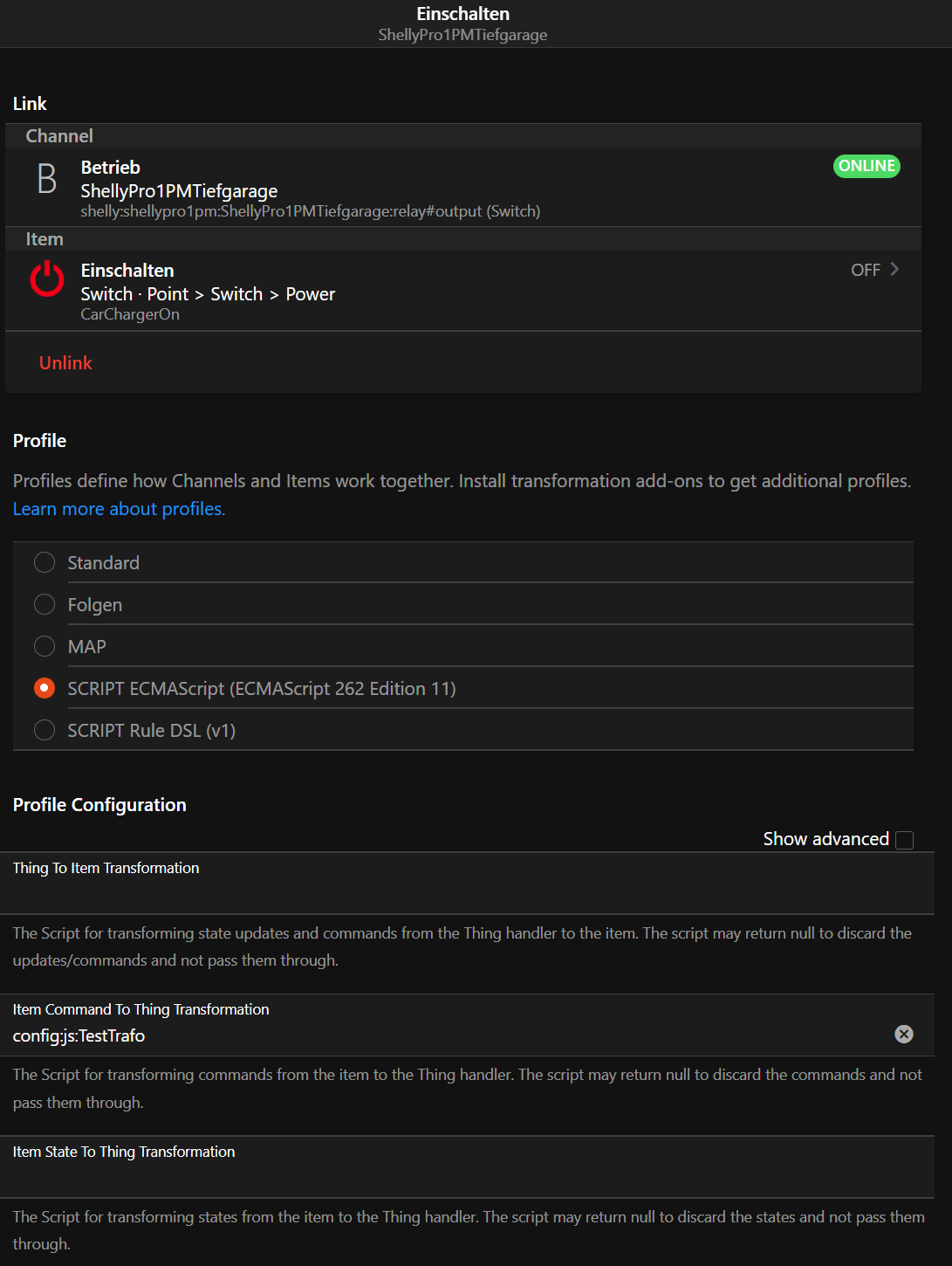

I assume that you’re talking about script transformation profile that you apply to item to channel link, like this one below:
Switch CarChargerOn { channel="blahblah" [ profile="transform:JS", commandFromItemScript="yourscript.js" ] }
The documentation for this is here: Transformations | openHAB
In this case, returning null should discard the command and not propagated to the channel / handler / binding. So the binding will never see the command.

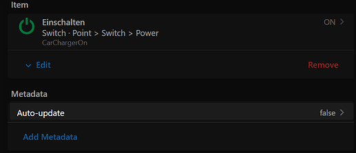

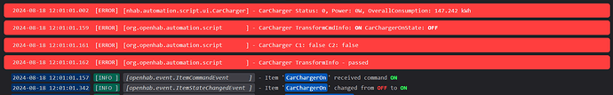

Here is more information about my configuration.

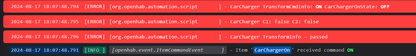

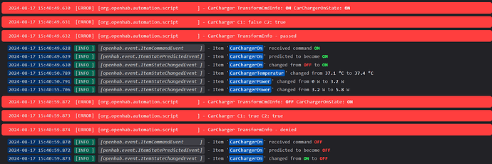

I have tried this code:
(function(data) {
  return null
})(input);

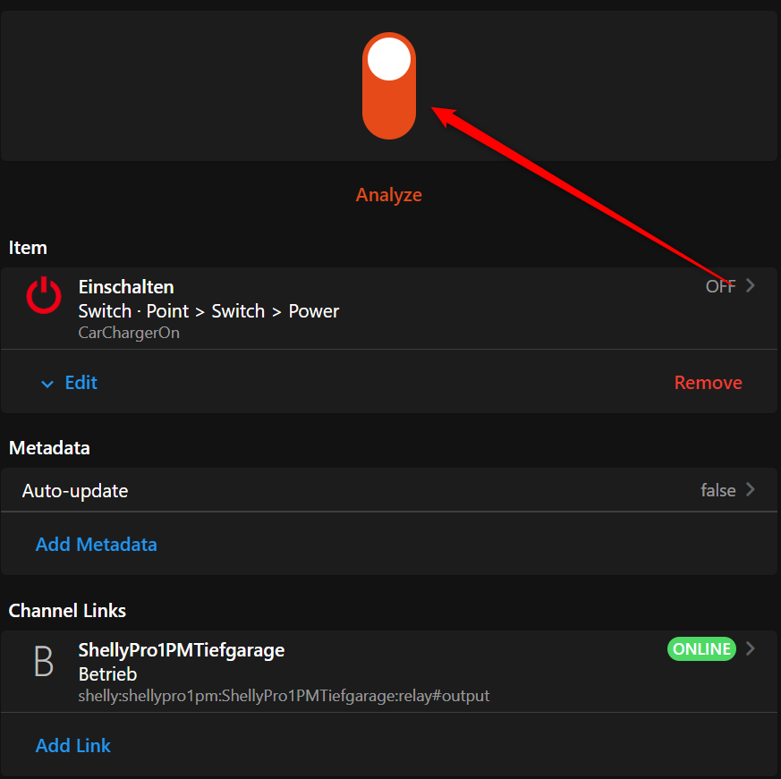

Then I set the switch to “On” in the GUI. And the switch in the GUI becomes true and stays true. I thought with Auto-Update set to false, the item in the GUI should remain false, but I’m not sure if I have understood that correctly.
The log shows that the command was received, and it appears to have been discarded, the hardware behind the channel remains definitely off.
When I toggle the switch back to off in the GUI, nothing happens. I would expect to receive a ‘CarChargerOn’ command OFF.
but nothing happens. Maybe because we have an asynchronous state between item and GUi?

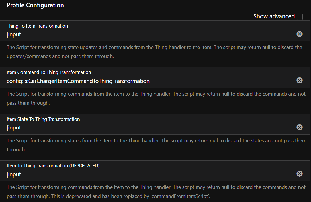

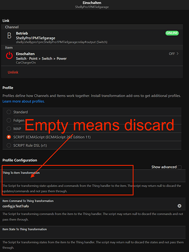

That extra bit of information helps!

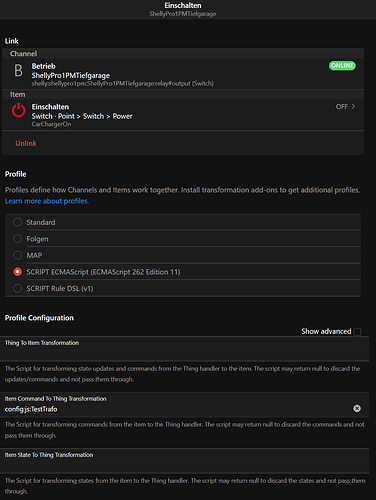

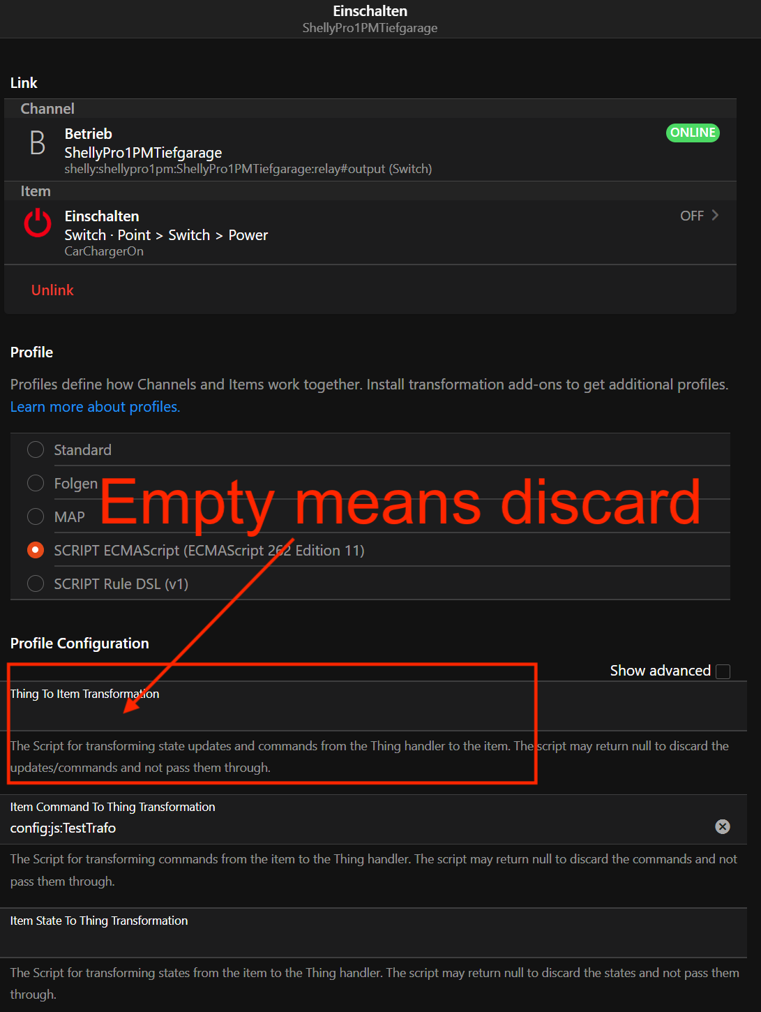

So when the shelly relay is OFF, and you send an ON command to it, the Shelly didn’t physically turn on? If you haven’t tried it, can you please try it? Feel free to use your original script as you posted in the original post above. I believe it should work.

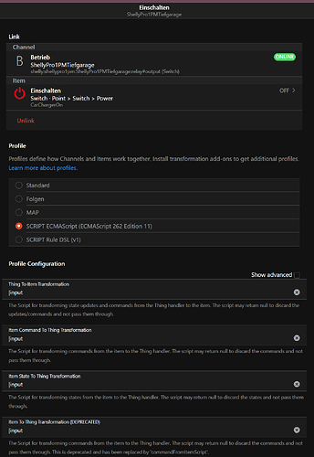

There is another problem: the state update coming from the binding to the item is being discarded because you haven’t specified a script for it.
To fix this, create a pasthrough script that just returns the input.
Or just enter this in that input field: |input

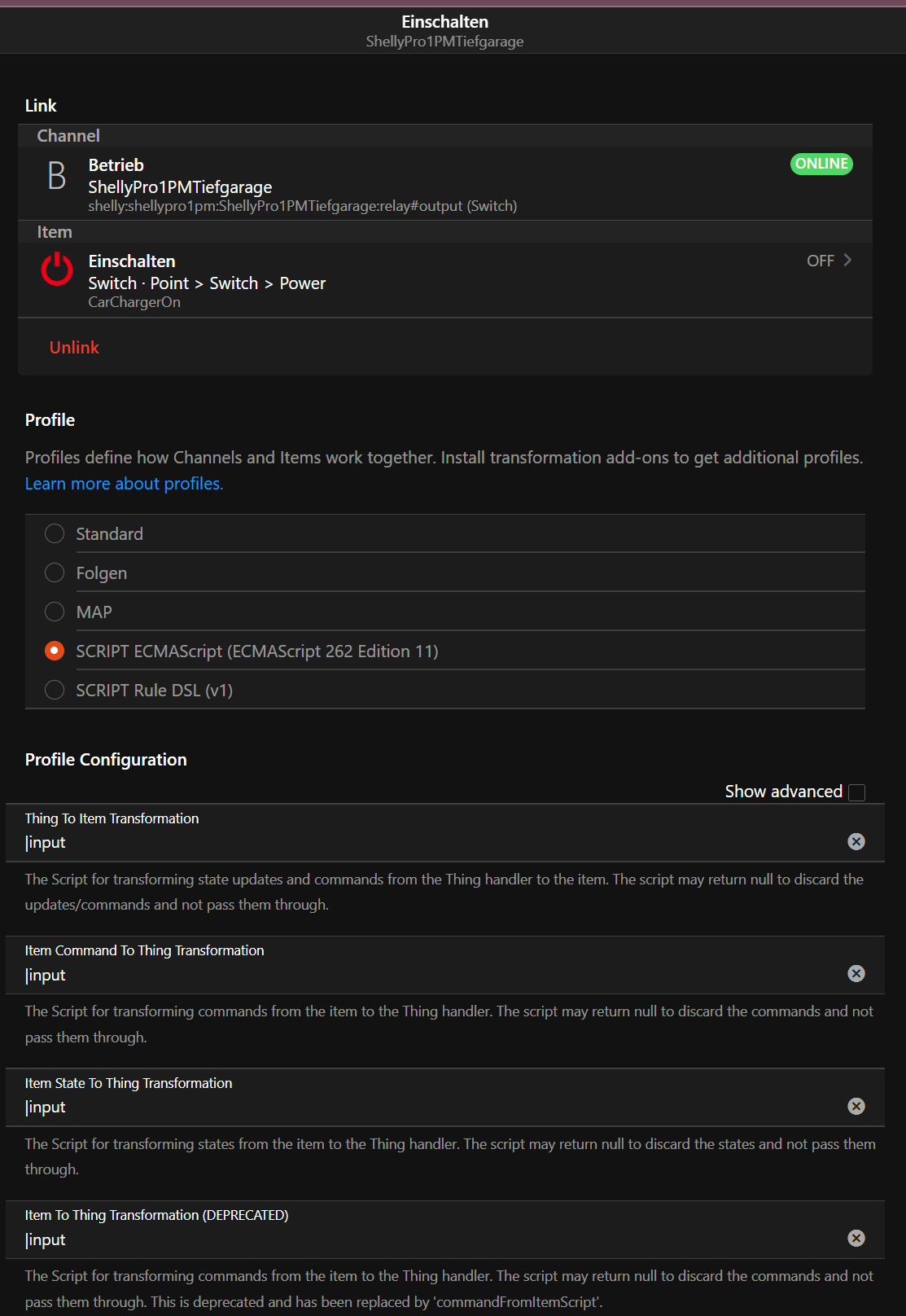

Thats helps me a lot.
But one question, would should I do with:
“Item To Thing Transformation (DEPRECATED)” leave it empty or “|input” ?
First, I want to create a configuration that just passes everything through?
Is this the right configuration?

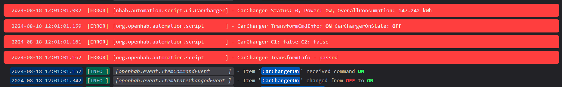

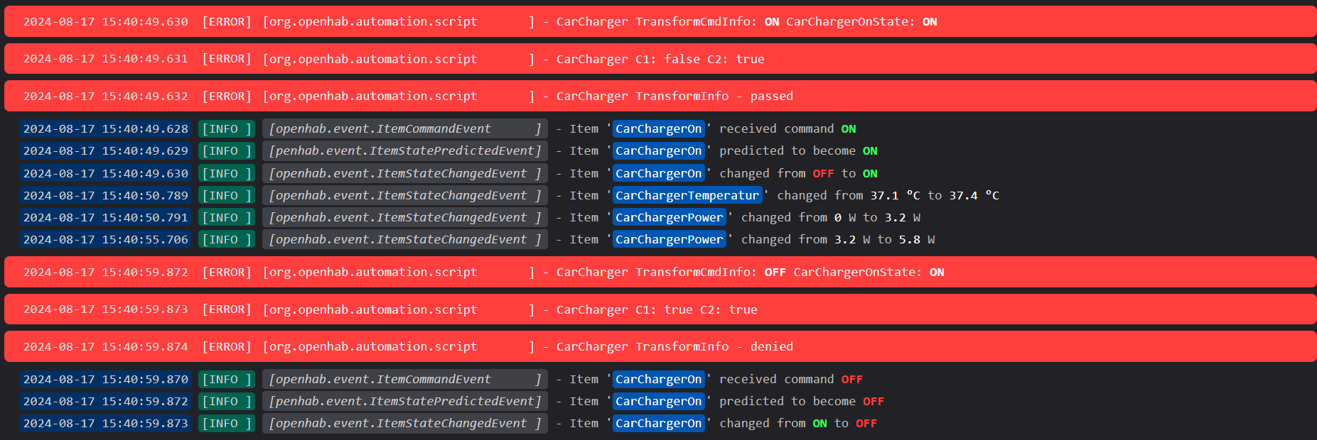

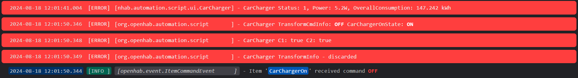

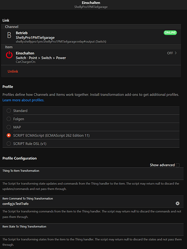

And now I’m testing this:
config:js:CarChargerItemCommandToThingTransformation:
(function(data) {
  const carChargerState = items.getItem("CarChargerOn").state;
  console.error(`CarCharger TransformCmdInfo: ${data} CarChargerOnState: ${carChargerState}`);
  console.error(`CarCharger C1: ${data === "OFF"} C2: ${carChargerState === "ON"}`);
  if (data === "OFF" && carChargerState === "ON") { //Later on we will monitor the current, if it is above 9A, we will denie switch off
    console.error("CarCharger TransformInfo - discarded");
    return null;
  } else {
    console.error("CarCharger TransformInfo - passed");
    return data;
})(input);
I started with a switch off device.
Then I set the switch to “On” in the GUI. And the switch in the GUI becomes true and stays true. Everything works as expected. The transformation script has been called, and has passed the command.
Then I set the switch to “Off” in the GUI, the switch in the GUI becomes false.
The TransformationScripts discards the command, and the Item stays “ON”.
The problem is, that the switch in the GUI becomes false, so we have an asynchronous state between the GUI and the Item.
An further “switch On” from the gui doesn’t invoke an “ON command”, the logs remain empty.
I think the transformation script works fine, but the problem is the gui.
You can do either, because if you specified “command from item”, the “item to thing (deprecated)” will be ignored. So you might as well leave it empty.
yes
I would probably leave “Item state to Thing” empty so it gets discarded. It shouldn’t normally be used. It shouldn’t affect you in this instance though, unless you manually update the item’s state, in which case you must leave it empty.
And also leave the deprecated one empty as explained above.
For clarity, I would probably rename data to command. Your code will read better that way.
This is when you really need to set the item to autoupdate="false".

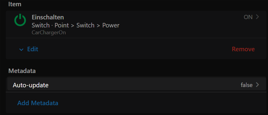

good idea, I just did it
it was already set to false during all tests today.
You are right, I will try to be more precise:
I’ve tested this, with this short script:
console.error(`CarCharger  Item Status: ${items.getItem("CarChargerOn").state} `);
summarized
  • GUI becomes false and remains false even after refreshing the website
  • Item in Openhab remains true
  • physical device remains true/on
ON and OFF Commands are handled correctly. When an OFF Command is discarded, the gui stays correctly ON.
The remaining problem is that a discarded OFF command leads to an asynchronous state between the item (also the physical device) and the GUI.
