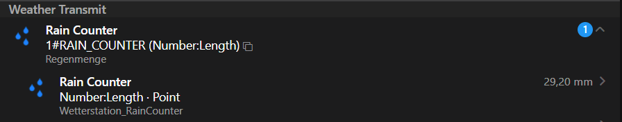

The binding in openHAB looks like this:

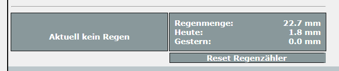

In my CCU3 it looks like this (I do not why the amount of rain is approx 22 and not 29 as seen in the previous screenshot, that is not my question):

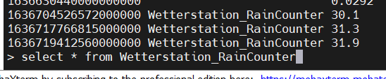

I have put water inside the sensor three times today.
As you see I got three measurements:
By the way, I recognized that the sensor increases the water amount all the time. On Homematic CCU3 WebGui is a reset button, but this button just resets “virtual” / “internal” system variables, and probably not the global counter.
These are the moments where I put the water:
Fri Nov 12 2021 09:08:46 GMT+0100 (Central European Standard Time)
1636704526572000000 Wetterstation_RainCounter 30.1
Fri Nov 12 2021 12:49:26 GMT+0100 (Central European Standard Time)
1636717766815000000 Wetterstation_RainCounter 31.3
Fri Nov 12 2021 13:16:52 GMT+0100 (Central European Standard Time)
1636719412560000000 Wetterstation_RainCounter 31.9

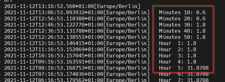

Tested with my previous mentioned rule file:
logInfo("INFO", String::format("%s   Minutes 10: %s", now.minusMinutes( 10), Wetterstation_RainCounter.deltaSince(now.minusMinutes(10))))
logInfo("INFO", String::format("%s   Minutes 20: %s", now.minusMinutes( 20), Wetterstation_RainCounter.deltaSince(now.minusMinutes(20))))
logInfo("INFO", String::format("%s   Minutes 30: %s", now.minusMinutes( 30), Wetterstation_RainCounter.deltaSince(now.minusMinutes(30))))
logInfo("INFO", String::format("%s   Minutes 40: %s", now.minusMinutes( 40), Wetterstation_RainCounter.deltaSince(now.minusMinutes(40))))
logInfo("INFO", String::format("%s   Minutes 50: %s", now.minusMinutes( 50), Wetterstation_RainCounter.deltaSince(now.minusMinutes(50))))
logInfo("INFO", String::format("%s   Hour  1: %s", now.minusHours( 1), Wetterstation_RainCounter.deltaSince(now.minusHours( 1))))
logInfo("INFO", String::format("%s   Hour  2: %s", now.minusHours( 2), Wetterstation_RainCounter.deltaSince(now.minusHours( 2))))
logInfo("INFO", String::format("%s   Hour  3: %s", now.minusHours( 3), Wetterstation_RainCounter.deltaSince(now.minusHours( 3))))
logInfo("INFO", String::format("%s   Hour  4: %s", now.minusHours( 4), Wetterstation_RainCounter.deltaSince(now.minusHours( 4))))
logInfo("INFO", String::format("%s   Hour  5: %s", now.minusHours( 5), Wetterstation_RainCounter.deltaSince(now.minusHours( 5))))
logInfo("INFO", String::format("%s   Hour  6: %s", now.minusHours( 6), Wetterstation_RainCounter.deltaSince(now.minusHours( 6))))
logInfo("INFO", String::format("%s   Hour  7: %s", now.minusHours( 7), Wetterstation_RainCounter.deltaSince(now.minusHours( 7))))
logInfo("INFO", String::format("%s   Hour  8: %s", now.minusHours( 8), Wetterstation_RainCounter.deltaSince(now.minusHours( 8))))
logInfo("INFO", String::format("%s   Hour  9: %s", now.minusHours( 9), Wetterstation_RainCounter.deltaSince(now.minusHours( 9))))
Looks good so far:
