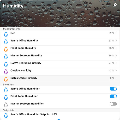

What if all those sensor readings were just labeled with “Humidity”? In fact, in this particular case, because it’s obvious what the Item is based on its icon I’m toying with the idea of not even putting what it is in the label at all (see the Den entry). But I need to play some more to see the impact of doing that in other places (e.g. finding Items in the Items settings and developer sidebar and the like).

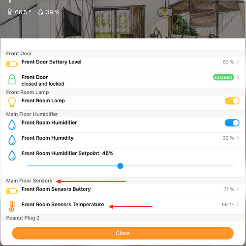

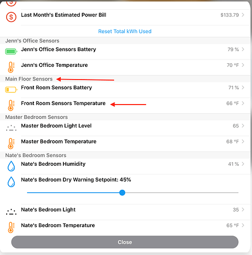

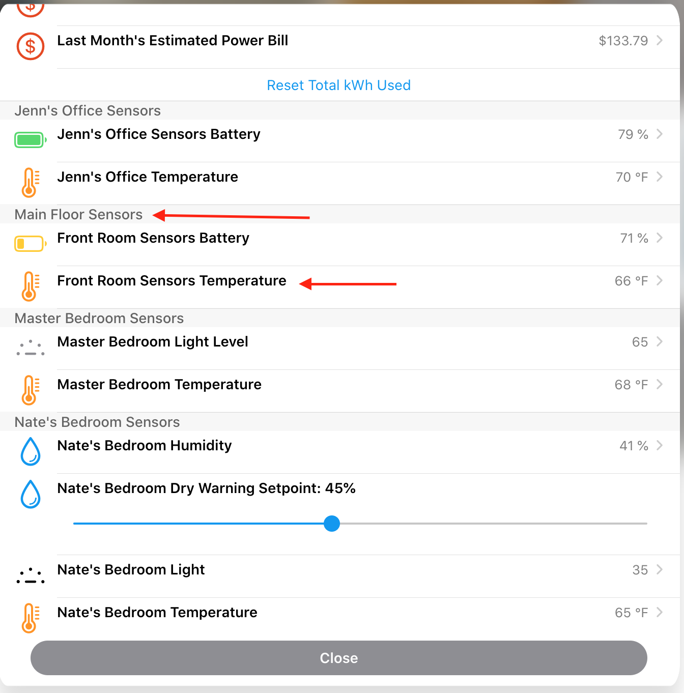

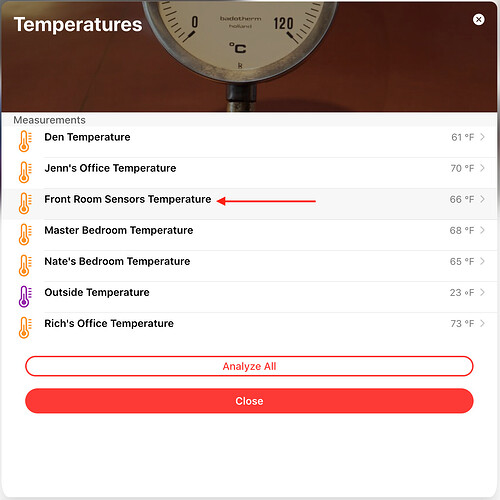

NOTE: Yes, I have some naming inconsistencies. The Equipment is called “Main Floor Sensors” but the temp is labeled “Front Room Sensors Temperature”. It’s on the list (but way down at the bottom) to fix that at some point.
So far so good though notice that there is no Location. The only way I know where that equipment is is because I included the location in the Equipment and Point’s Item label. But on the Properties tab…
Notice, no Equipment and no Location is anywhere. The only way to tell one temperature reading from another is to make each one’s label unique and meaningful.
