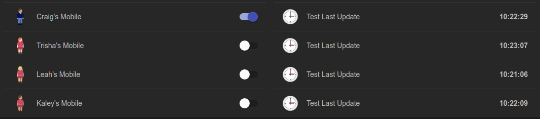

Alba, thanks for the data. I have done this but I have a group of family members who I only want to update the Last Seen time frame if they are on the local network. My Daughter is away at college but with this approach, the time still updates when she is not here which defeats the purpose. I have included an image. What I need to do is find some ‘if clause’ that checks if she is on the network but I am new to this and not sure how to do that. Does this make sense?
Craig
