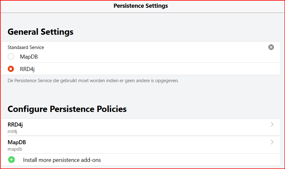

What is your persistence definition for laatsteafsluitingopenhab?
I’ve tried a few times to wrap my head around this entire persinstence concept. But I keep failing.
This is what my persistence settings window looks like:
rrdj4 persistence configuration:

rrd4j does not store DateTime item types I believe. It is only for numeric values, see documentation.
You can use another db if you absolutely want this.
An alternative is to use mapdb to get the last value before shutdown.
The challenge I also see is how to make sure to only persist when shutting down. How do you update that laatsteafsluitingopenhab item?

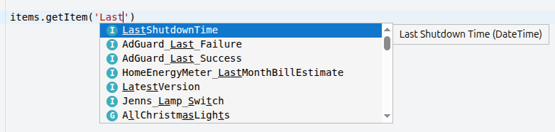

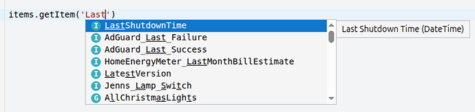

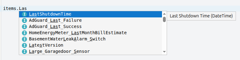

Some stylaistic notes about the code.
There are several ways to access an Item like this:
items.laatsteafsluitingopenhab
items["laatsteafsluitingopenhab"]
items.getItem('laatsteafsluitingopenhab')
The advantage of the first and last option is I think the intellisence built into the MainUI code editor can more reliably autocomplete the Item name (ctrl-space).
