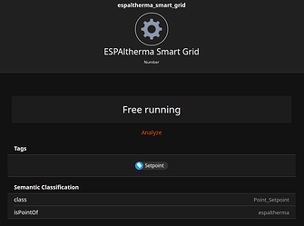

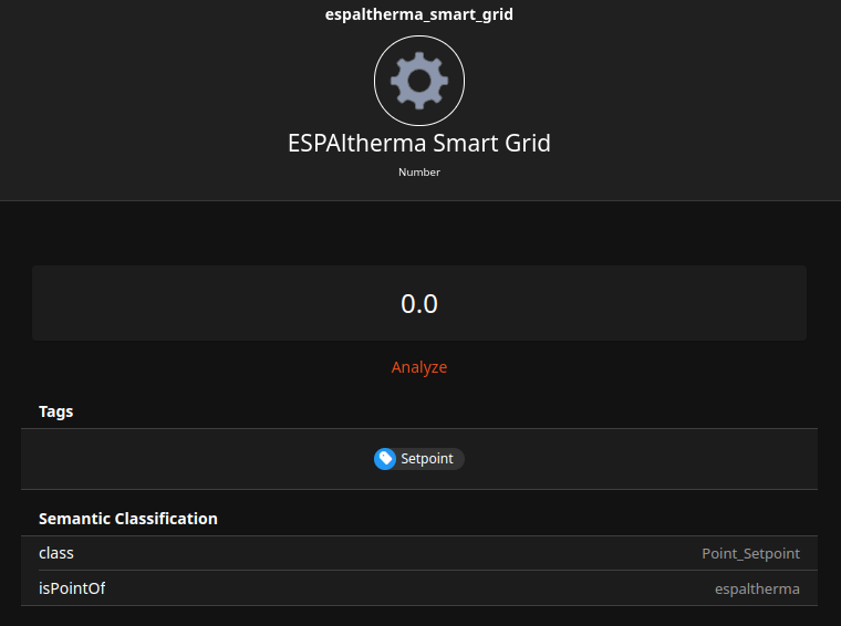

I have a problem with an item that displays the state description incorrectly after restarting openHAB 4.0.3. Only when sending a command, the items state description will be displayed correctly.
My guess: when loading from InfluxDB, a float is parsed, but my state description defines integer.
You’ve configured the Thing to return integers with your transformationPattern and that’s probably why sending the command converts it to an integer. But persistence is always going to update the Item using a float.
I’m not sure how options work, whether it works on the state description transformed state or the raw state. So I don’t know switching to %d will work. But it’s worth trying.
Given you are not doing any math with these values, is there some reason you are not using a String in the first place? Or make the mapping between the number and the String through a transform on the Thing.
It looks like the pattern and the options fields used in this way are not compatible. It’s kind of an odd use case to use options with numbers anyway for this very reason. They are usually expected to work with Strings.
Basically the value is string from MQTT. It does not matter what transformation I use in the channel, it is never read when restarting openHAB as long as it’s not updated. The problem must be somewhere between the persistence and the thing. When looking at the InfluxDB the values are stored as integers or a string representation without floating point, so 0, 1, 2 or 3.
Persistence always restores the state of Number Items as floats.
Your MQTT Thing is configured to transform the string coming in to a Number.
Agreed, there is nothing you can do on the Thing that will change one bit about the value restored from Persistence. That happens completely independently.
Well of course. You’ve told it may times over you want a number. You convert the value in the Thing to a number: JS:|parseInt(input). You store is in a Number Item. type: Number. So Persistence is going to save and restore the value as a number in InfluxDB.
And as I’ve already mentioned, Persistence is always going to restore a Number Item using a float.
However, if you change the MQTT Channel Type to a String and the Item type to a String a String will be saved in InfluxDB and therefore it will be restored as a String. No decimal places will get added. Everything will be the same.
Furthermore, the MQTT Thing configuration will be simpler as you won’t require the formatBeforePublish nor the transformationPattern because it stays the same String from end to end.
You could furthermore use a MAP transform on the MQTT Thing to do the mapping between the “number” and the human readable string instead of as options on the State Description. Then instead of seeing “0” in your logs, rules, the Items page, in the database etc. you’ll see “Free running”.

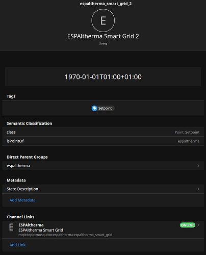

When using a string Item for the same channel, things get even very strange. Here I’m using %s as state description format. The state renders as datetime…
@rlkoshak Ok, now I completely redid the channel and linked a new item, both string. That does the trick, thanks a lot. For some reason the configuration got damaged when changing item type.
