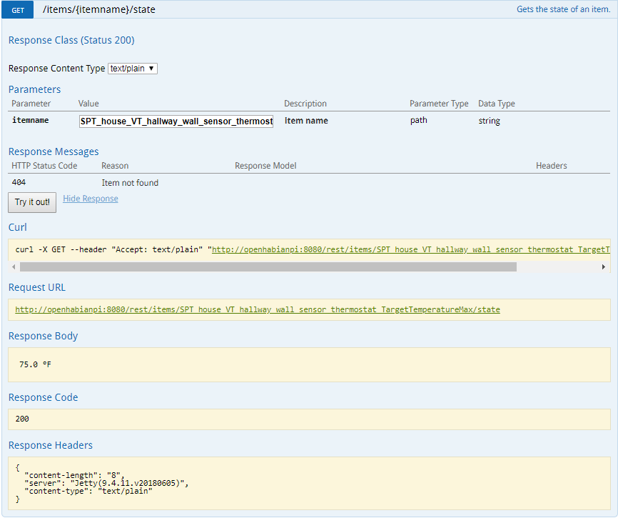

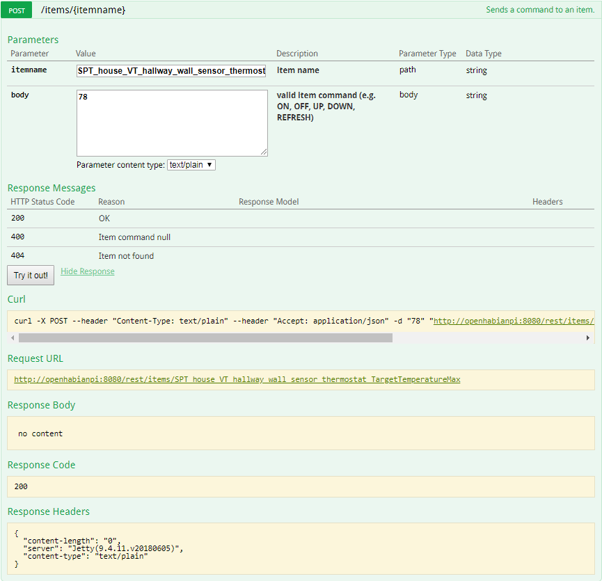

Today I decided to use the REST UI to work my way upward toward the CalDav binding. I used the Item POST to send a value to the Item followed by an Item GET to look at the state.
These log entries are as the result of my interaction with the REST UI.
2019-02-27 09:41:56.366	ItemCommandEvent	Item 'SPT_house_VT_hallway_wall_sensor_thermostat_TargetTemperatureMax' received command 78
2019-02-27 09:45:19.142	ItemCommandEvent	Item 'SPT_house_VT_hallway_wall_sensor_thermostat_TargetTemperatureMin' received command 71
The images below show that the “Max” (name appears truncated due to length of Item name vs. the length of the text box) POST completed successfully (200), yet when I look at the Item state it does not match the value I just set. In fact, it is the value at which the Item has been stuck at since this problem started.

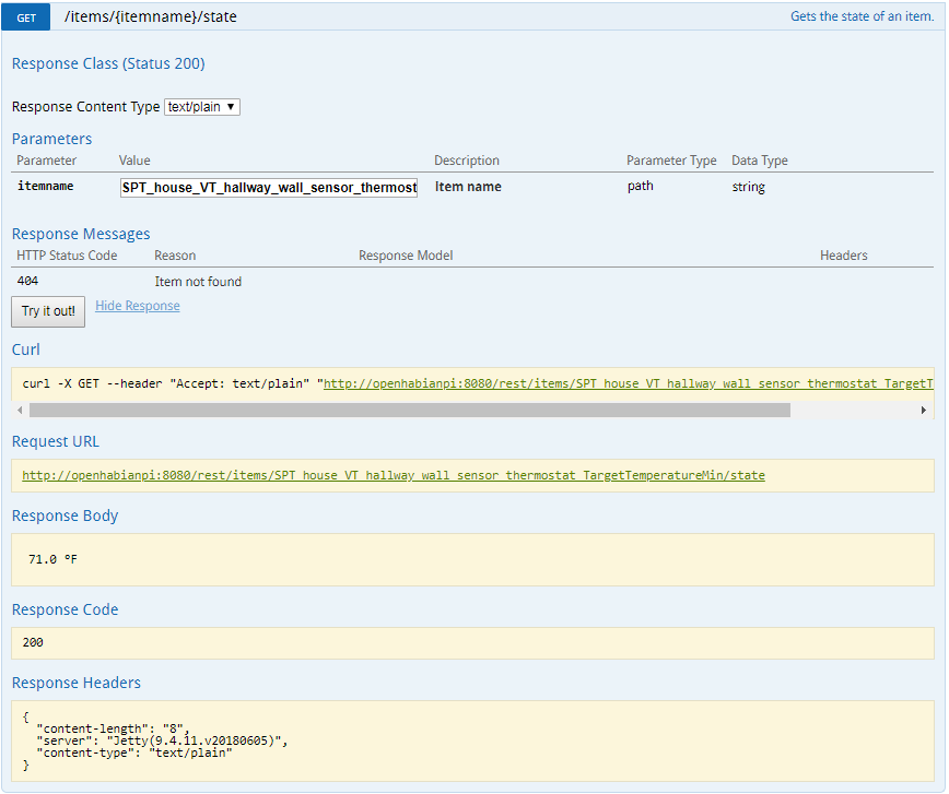

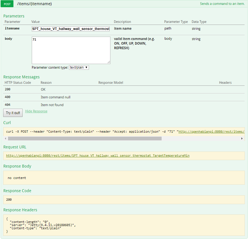

When I perform the same actions for the “Min” Item, it updates as it should. The images show that as well.
REST UI Actions for “Max”
REST UI Actions for “Min”

2019-02-28 00:22:26.724 [ome.event.ItemCommandEvent] - Item 'SPT_house_VT_hallway_wall_sensor_thermostat_TargetTemperatureMin' received command 44
2019-02-28 00:22:26.739 [vent.ItemStateChangedEvent] - SPT_house_VT_hallway_wall_sensor_thermostat_TargetTemperatureMin changed from 12.0 °C to 44.0 °C
I’m pretty sure caldav will use the same REST methods to communicate with openHAB, since there’s no real binding to Items?
Based on it originally working and what you’ve researched… I’d have to concur.
