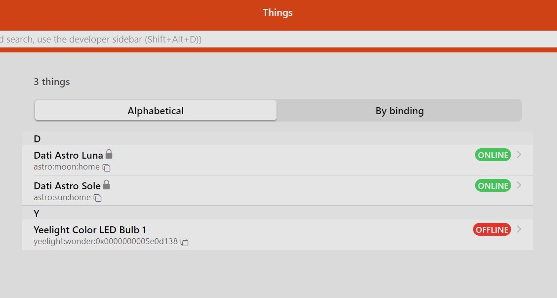

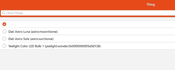

I found the problem..
Trying Blockly’s “get thing status” block, I discovered that the thing list is almost empty…
None of my things (defined in .thing file) are listed in the blocly pick list ..
01 prima|400
..neither in the main UI things page !
01 Blockly thing list
After refreshing the .thing file
(with echo “” >> /etc/openhab/things/astro.things command)
objects appear in the list:
Blockly thing list
and in the main UI things page !

Are you sure the missing Things were working in the first place? They seem to have been in some sort of inbetween state where they sort of existed but not fully existed. Both the call to thing.getThing() and the REST API call that populates the Things page get that information from the ThingsRegistry. If both are showing that the Thing doesn’t exist that means that as far as OH core is concerned those Things do not exist.
You will get the same behavior from any of the rules languages that support access to the ThingsRegistry. It’s not specific to JS.
What ever happened should be a rare occurance. In fact it should never happen again. If it does happen again an issue needs to be files to figure out what happened and fix it.
And while this is supposed to work and must be made to work properly, one of the reasons (not the bioggest reason, just one among several) I don’t use file based configs is weirdness like this which can crop up.
