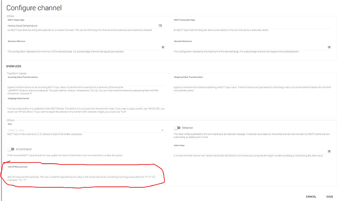

You should almost never need a transformation to convert units anymore. That’s what units of measurement is all about and all that discussion above about what is and is not supported is no longer valid.
  • You can set the unit on the MQTT Thing.
  • MQTT Things do support Number:Temeprature Items.
  • It’s now easy to post the Thing by clicking on the code tab.
In just about any version of OH after 3.0 and definitely after OH 4.0, the general approach to this would be:
  • set the Item type to be Number:Temperature
  • set the unit on the MQTT Channel to °C (this tells OH what unit is being received by the Channel)
  • optionally set the unit metadata on the Item to °F (if your regional settings are set to Imperial this step is optional, OH will already assume °F is what you want)
The rules for units are:
  1. if a value with a unit is updated to a Number Item without a type, the unit will be stripped
  2. if a value without a unit is updated to a Number Item with a type, a unit will be applied (see below for how the unit is applied)
  3. if a value with a different unit is updated to a Number Item with a type, the value will be converted to the Item’s unit.
The units that get updated to an Item is chosen as follows:
  1. Number Items without a type never have a unit.
  2. Number Items with a type always have a unit.
  3. The unit defined in the Item’s unit metadata is always going to take precedent over everything else.
  4. If the unit metadata is not defined, the system default unit is chosen. What the default is depends on regional settings (e.g. if SI is chosen, the default for Temperature will be °C, if Imperial is chosen the default will be °F)
No transformation is required for units.
