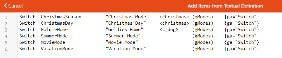

I imported these items:
and the parsing was ok.

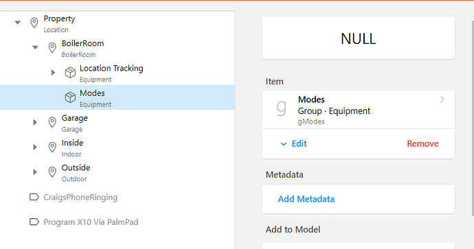

My model shows:
Indicating no items belonging to Modes. Note that “Show non-semantic” is selected

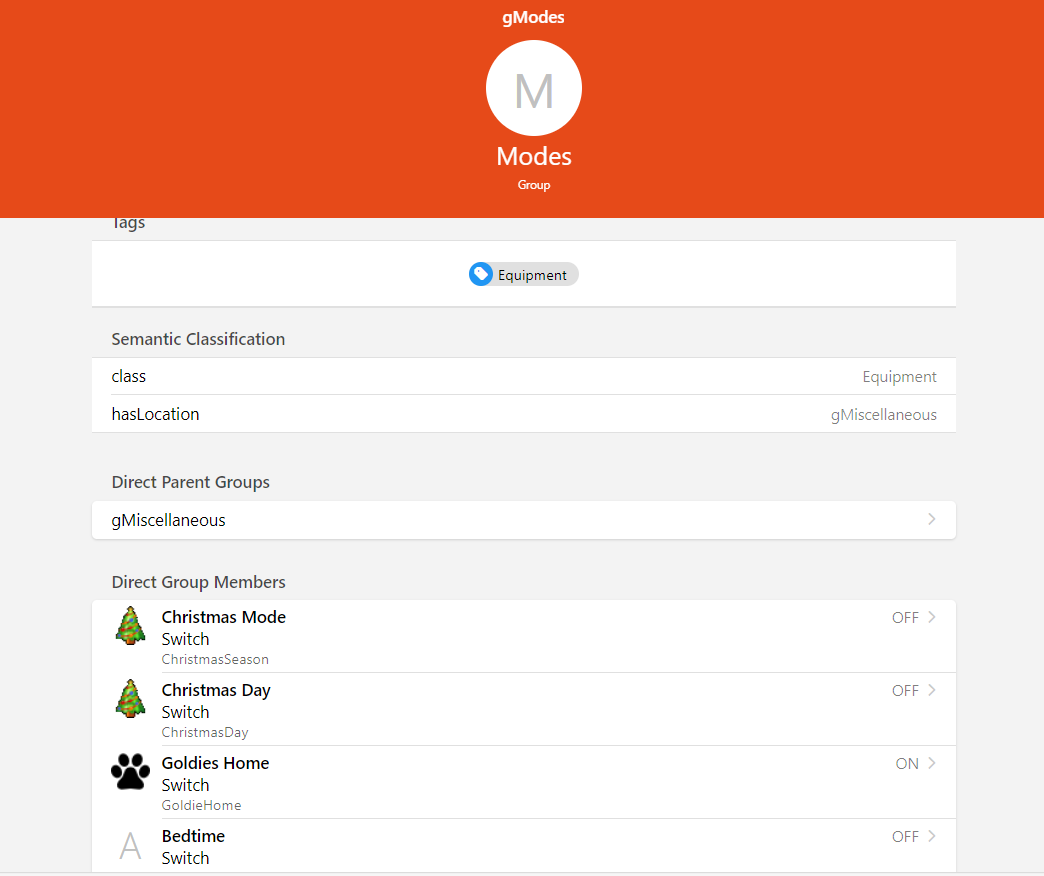

However, if I go into “Modes”, the members show up.
I see this:

The items themselves do not have any semantic tags. Just because an item is a member of a semantic group it is not yet part of the model. An item must also have one or more appropriate semantic tags.

I realize I don’t have semantic tags for them, but they should still show up in the model if I enable “Show non-semantic”.

Nope. Not with what you’ve set up. If you take them out of the semantic group (or maybe put them all into another group that is non-semantic, not sure if that will work in this case) then they will show up in the bottom part of the model list when you enable “Show non-semantic”. But right now the system is essentially malformed because it is trying to put those items in a semantic group but cannot because they don’t have any appropriate tags.
