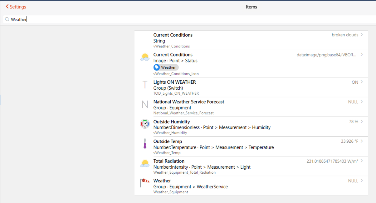

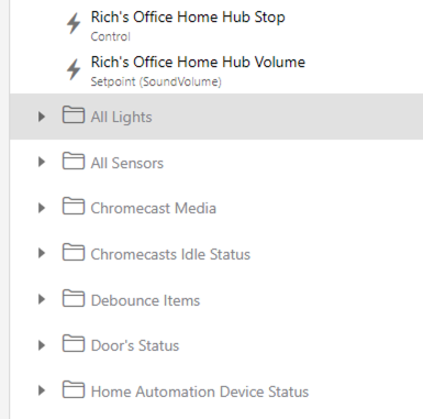

Create Groups to organize the Items outside the semantic model, when the “show non-semantic” is checked your Items will also appear hierarchically based on Group membership. In the screenshot below of my Model page, everything from “All Lights” and below are non-semantically tagged Groups which can be opened to see the members of those Groups.

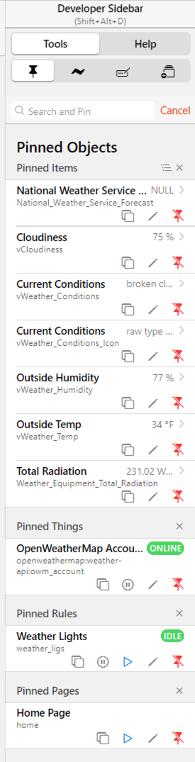

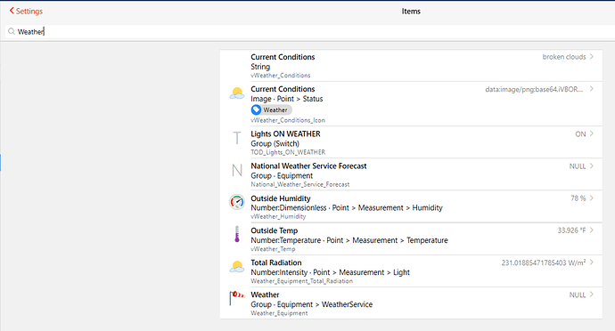

Use search or the Item selection dialog in the developer sidebar and pin the Items that you are working on at any given time. Notice that you can navigate between Items and if the Items are actuators, you can send commands to these Items from the sidebar. Also, you can pin Things, Rules, and any other OH entity to the sidebar at the same time, navigate to them and disable/enable and run all from the sidebar.
