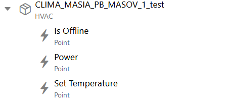

Created via PaperUI, points show up in the tree:

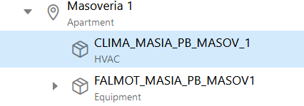

Created via items file:

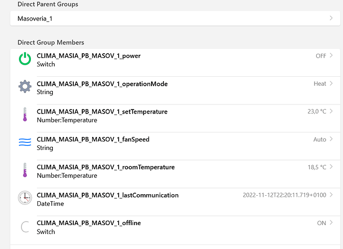

Opening the group item in the modeltree in the version with the file, all items are however there:

What You descibe is normal, as your .items file(s) do(es) not contain any semantic tagging, therefore you will not see those Items in the model, unless you use the little tic box at the bottom.
Then you will see all items.
