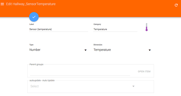

I have been adding and linking items for my things using both PaperUI and HABmin; over time, I have added a number of things that are of the same type, but I notice that the item values don’t display consistently. In PaperUI’s Control section, the values display but some lack units. In some other UIs like the BasicUI or in the OpenHAB app, the values can be missing altogether (even though they display in PaperUI and HABmin.
I am creating/linking my items through PaperUI and HABmin using the default settings and as far as I can see in the web interface, the configuration is the same.
What might I be missing in setting this up correctly?
As an example, these are two things that are the exact same type (Z-Wave motion/temperature/light sensors):
