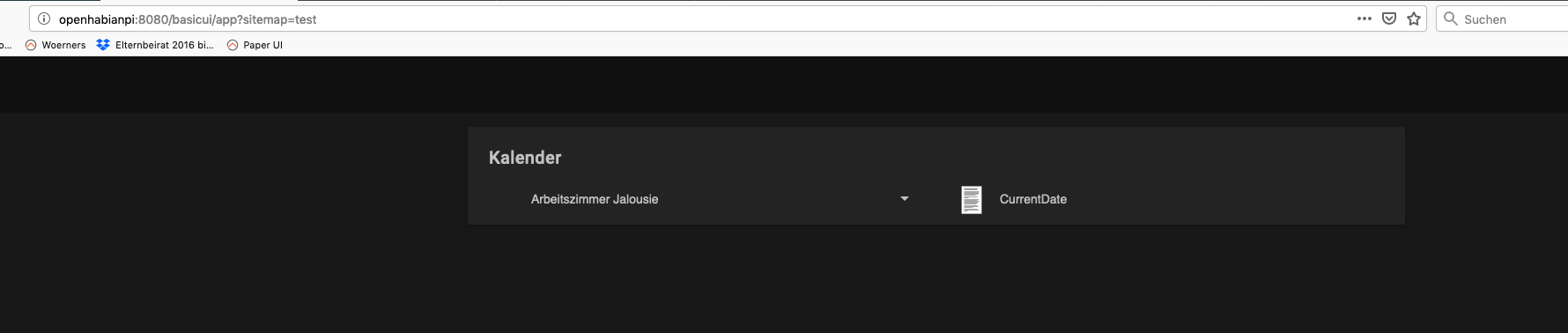

I added your code in the sitemap, but it doesn´t show anything. See attached the full code of the test sitemap
sitemap default label=“Test” {
Frame label=“Kalender” {
Selection item=Arbeitszimmer label=“Arbeitszimmer Jalousie” mappings=[0=“offen”, 100=“zu”, 25=“Beschatten”, 75=“Wenden”]
Default item=CurrentDate label=“CurrentDate [%s]”
Default item=Arbeitszimmer label=“Arbeitszimmer [%s]”
Text item=CurrentDate
58
This is what is shown in the browser.
I also changed the name of Date to CurrentDate, but no change.
IN the log I just find the info that the NTP updated.

But this was in file test.sitemap ?
sitemapname shall always be equal to the Sitemaps file name
Use
sitemap test label=“Testing” {
https://www.openhab.org/docs/configuration/sitemaps.html#special-element-sitemap
ok, that makes sense. Then it is explained why it refered to the default sitemap.
But why the astro binding determines the current date even though ntp binding is installed is somehow strange to me. ;.)
No idea what you are on about there, it’s all been sitemaps so far.
You showed us an event.log where an Item called ntp_ntp_local_dateTime got updated, but none of the sitemap you have shown us includes that Item.
There has been no mention of Astro until now.
