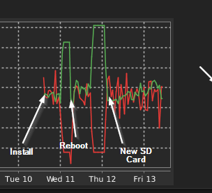

This was the sensor result:
After a reboot it worked for some time, and then system just stopped fetching sensor data.
I could login without problems and the system was completely usable, it just stopped receiving data.

It wasn’t the SD card. The second, brand new 16 GB card showed the same after some days.
It was just the bluetooth sensor service stopping after any communication problem. I noticed it today by purposely removing a single sensor. As soon as the communication broke once, the service stopped completely.
