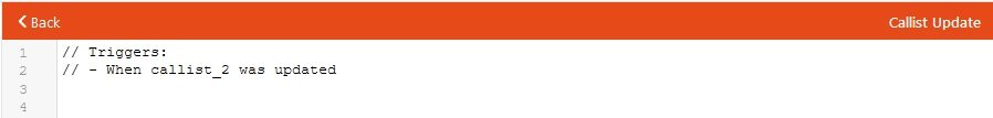

Just one additional question: I noticed that the file based JS rules are not displayed correctly in the OH Main UI. Only the trigger is displayed correctly, but not the source code:

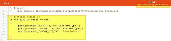

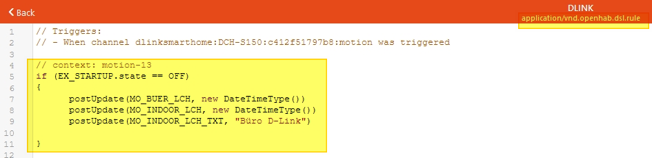

Contrary to this, all my old file based Rules DSL rules are recognized by their type (vnd.openhab.dsl.rule) and show the source code:
The same problem exists when I access the rules via the REST API (which of course is the same what the Main UI does). The info for source code (actionscript) and rule type (actiontype) are not filled. Is there a chance to improve this? For JS rules that are defined via Main UI this information is displayed correctly, the problem exists only with file based JS rules with the helper libraries.
Just to clarify: The rules run perfectly, they are just not accessible through the UI or the REST API.
@vossivossi that is going to require some digging… Could you open an issue on github for this, I will take a closer look when I have time.

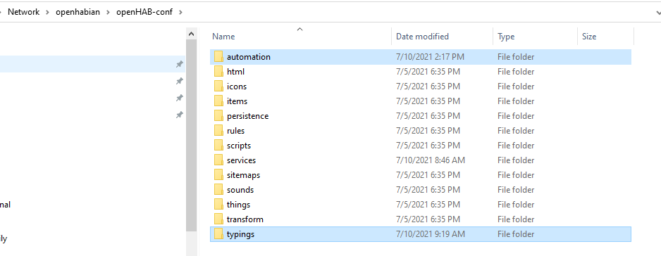

@mjcumming that’s basically the gist of it. The typings folder needs to be in automation though
