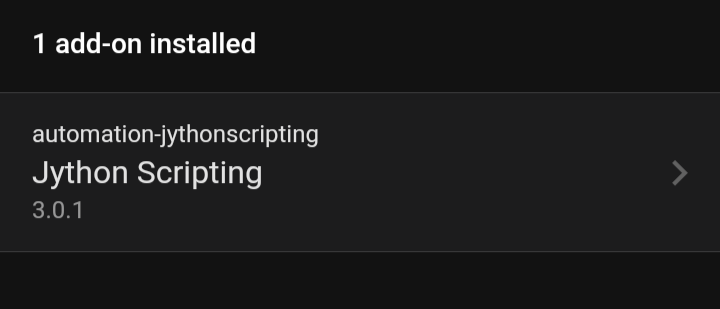

Step 5 - Install the Python Automation add-on.
Should that say
Step 5 - Install the Jython Automation add-on.
I left that alone because I want to limit the changes to the repo, at least for now, to ease reintegration. Assuming you came from the instructions you are quoting above, I would think it is implied that you should download my fork from the link you went past in the opening of the post. I will add a note above with the link again.
No, I believe in OH3 the add-on is actually called “Python” not “Jython”. That also makes sense, because you are coding in the language “Python” but we are using the interpreter “Jython” instead of the more familiar “CPython”. I am not able to confirm the add-on name right now, but if you can check and confirm the name is “Jython” I will update it.
Because other links in those step by step instructions link to your fork, except for the one highlighted one might assume it’s deliberate.
It’s Jython
I haven’t touched that page, that is odd. Which links point to my fork?
Updated! Thanks

Just looking at implementing this version of the Python/Jython OH Helper libraries on a dev machine and I’ve noticed that the RuleSimple.pyi file has been truncated in GitHub.
