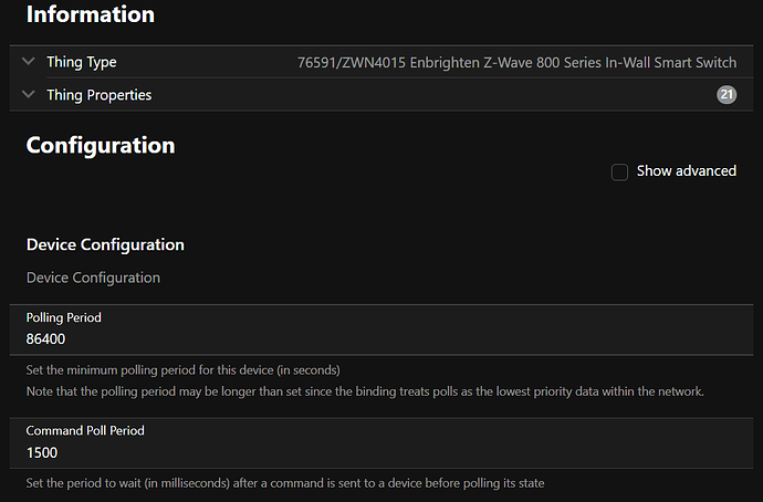

I managed to buy a switch about which OH doesn’t seem to have any information. OH identifies it as (0063:4952:3437:8.20), the paper “manual” that came with it mentions 76591 and ZWN4015. See attached node20.xml for node details from OH. I tried hacking together a description XML file, which “Thing Type File Provider” got me to a state where I can control the switch through OH, but I can’t configure it: OpenHAB thing UI just shows this:

Both mention matching Product ID, but not matching SKU. So I copied parameters from ZWN4016 adding couple more mentioned in the second page.
Am I missing something about thing configuration?

I did try restarting OH, deleting and re-adding the thing. Deleting the thing, excluding from ZW, including to ZW, re-adding to OH.
I added the type:id to this XML.
76592zwn4016_0_0.xml (6.1 KB)
You could try thing file type provider, I usually just replace the existing file in the jar with a compressed editor. The jar process does require the delete/scan. Couple of options
Thanks. That file works nicely. I had to patch .jar file for configuration parameters to appear. I was able to change the indicator color, it changed correctly.
