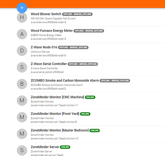

yeah i have the dashboad now as well, however if i go to my things it will start randomly dropping bridges…and then the influx of errors will start rolling non-stop in the logs.
changed config file to expert, rebooted and so far so good. I think I know why all bridges went offline, my house is to dependent on openhab…i’ll have to do that test tomorrow day lol.

I was able to reproduce the bridge error, if i go into services / addon’s and unhash the UI’s listed individually it takes all of my bridges offline (zwave for example). If I put the has back, it starts to rebuild but never fully does. Starts to get a java error.
That now has nothing to do with the libjli error. Please open a separate thread if you want help on that.
