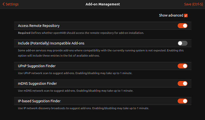

I think in your case the device communicates an empty host with port :30080 and not null. So probably an additional check (or catch) in the jupnp library needs to be added for it to be suppressed.
If you didn’t get this exception on older openHAB versions, it may be due to the “UPnP Suggestion Finder” which can be disabled in the “Advanced” settings of “Add-on Management”:
