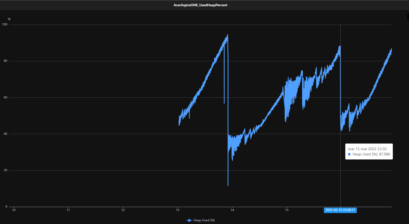

After a few days I got my first crash due to “java.lang.OutOfMemoryError: Java heap space” and since then I’m getting this error every 5 days.
I first tried to disable all my DSL rules (as suggested in a similar post) and then I tried to stop all the bindings, but noting changed (with all bindings and rules off, I’m still getting the error every 6 or 7 days…).
I’m monitoring heap space with Openhab System Info binding and I can see heap used percentage growing day by day…
