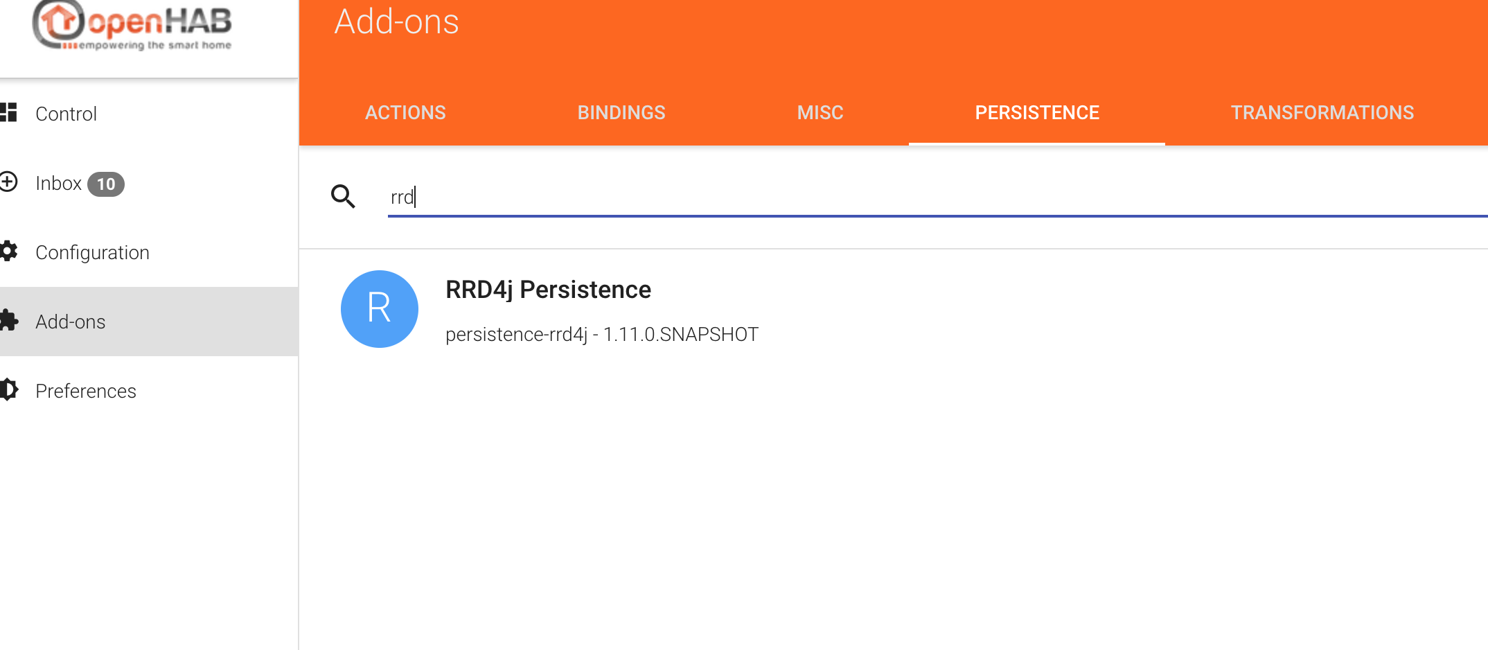

Can you try to resolve No Persistence service found. for example by installing RRD persistence addon
If that resolves it I might be able to setup a server at home which can reproduce this.

This service is already installed :wink:
That’s where the chart data is written to.
