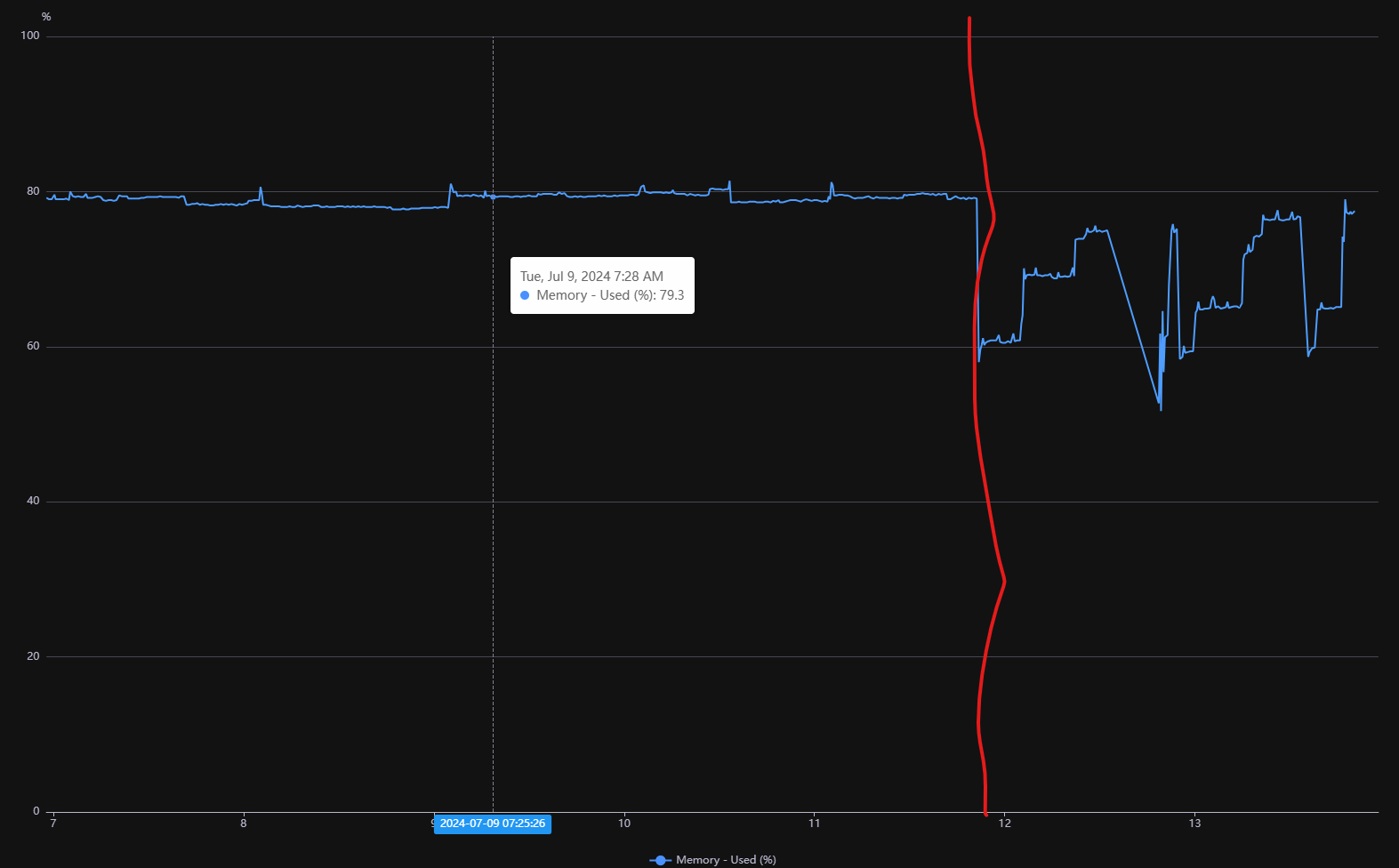

Update: At least judging from the systeminfo-binding, 4.2 does not seem to consume more RAM (left: 4.1.3, right: 4.2 with three freezes & reboots)..

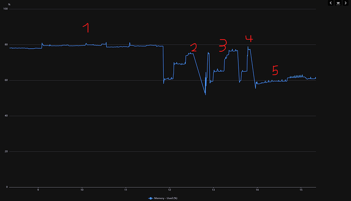

I‘ve investigated the freeze-problem, which was caused by RAM-issue, which occurred on my installation after updating to 4.2:
java.lang.OutOfMemoryError: Java heap space
2024-07-13 13:36:33.567 [ERROR] [org.apache.felix.fileinstall] - In main loop, we have serious trouble
2024-07-13 13:36:34.433 [ERROR] [e.automation.internal.RuleEngineImpl] - Failed to execute rule 'strom_split_stromzaehler': Failed to execute action: 2(Java heap space)
Below is the RAM graph of the systeminfo-binding of these instances:
  1. Stable operations with 4.1.3
  2. After the update to 4.2, two step changes in RAM, followed by a freeze for 6+ hours
  3. Restart of the container. Then the same two-step change in RAM, followed by a freeze
  4. Restart of the container. Then the same two-step change in RAM, followed by a freeze
  5. I then deactivated a single rule (see below), since then normal operations.
I changed two things, before things seem to have settled in #5: I purged all orphans (though this should not have caused the instability, since they’ve been there all along but not visible via the nice new feature), and deactivated a single rule that threw an error only after updating to 4.2:
2024-07-14 23:41:12.057 [ERROR] [internal.handler.ScriptActionHandler] - Script execution of rule with UID 'strom_split_stromzaehler' failed: cannot invoke method public default long java.time.chrono.ChronoZonedDateTime.toEpochSecond() on null
In case someone wants to investigate (is it possible that the “long” operations in the rule caused the RAM issue and ultimately the freeze?), let me know.
long is just the return type of the toEpochSecond() method. The reason for the error is that the method is being called on a variable that’s null.
Can you provide more info on the rule? The rule language, actual code, how often it is run etc. If it’s run very frequently and handles a lot of data, this could be left orphaned but still allocated when the rule crashes, leading to increasing memory use.

My guess is it’s this line where it fails:
I’m not sure when this change happened, but the lastUpdate() method returns null if the last persisted state is different from the current item state (see the docs), which could happen if the rule is triggered on item change: the new state hasn’t had the time to be persisted yet, so the one read is the old value. But it seems what you are after is the time passed from the previous change to the curren one, right? Then why not just use ZonedDateTime.now().toEpochSecond() instead?
Thanks.
And yes, maybe you‘re right. Though I‘m wondering why it only made 4.2 freeze, and all the other versions since 3.x worked fine.
Thanks! And yes, good point. As said, want to get rid of all my DSL rules soon, so have to do some refactoring.
