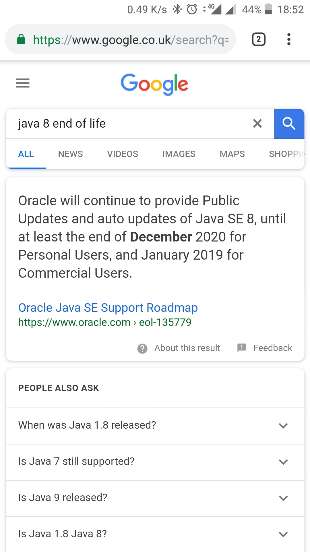

CDriver
(CDriver)
October 3, 2018, 5:54pm
4
Is this strictly the case?
