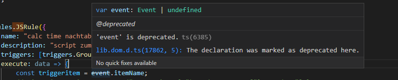

Hi Thanks for the answer. I tried it but it did not work.
Logfile says
2023-01-15 20:00:49.324 [ERROR] [tomation.script.file.calculations.js] - Failed to execute rule test-7c2eb777-9228-4012-a1b9-fd37c0d27403: ReferenceError: "event" is not defined: ReferenceError: "event" is not defined
at execute (calculations.js:22)
There is no real difference. They are both common names for the single parameter that the execute function accepts, you just need to use the right variable name inside this function.
You can basically name the parameter anything, but it makes sense to name it data or event because it gets the event data passed.
