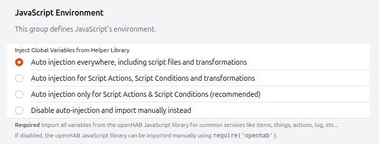

This feels like something to do with the new way things are injected? In the javascript settings page of the openhab UI, it looked like everything was set to automatic, but I don’t really understand what I’m looking at.

There’s nothing different about how this stuff is injected.
This determines how the openhab-js helper library is made available in your rule. It controls when the helper library is just there and available or when you need to explicitely import it using a require('openhab');

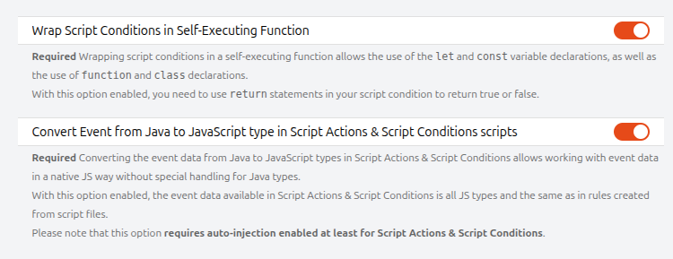

The wrap option enables the use of return, let and const in managed script conditions (i.e. UI rules). The script actions are automatically wrapped all the time.
The convert event option creates a wrapper around the event Object for managed rules users (i.e. UI users) same as .js file rules users get. See JavaScript Scripting - Automation | openHAB. Which this is disabled, the raw Java event object will continue to be injected into the script actions and script conditions.

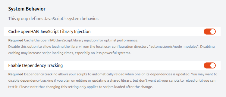

If you’ve installed the openhab npm manually the cache option must be turned off.
If you’ve one or more libraries, enable the second option to cause your rules which use a given library to reload when that library changes.
