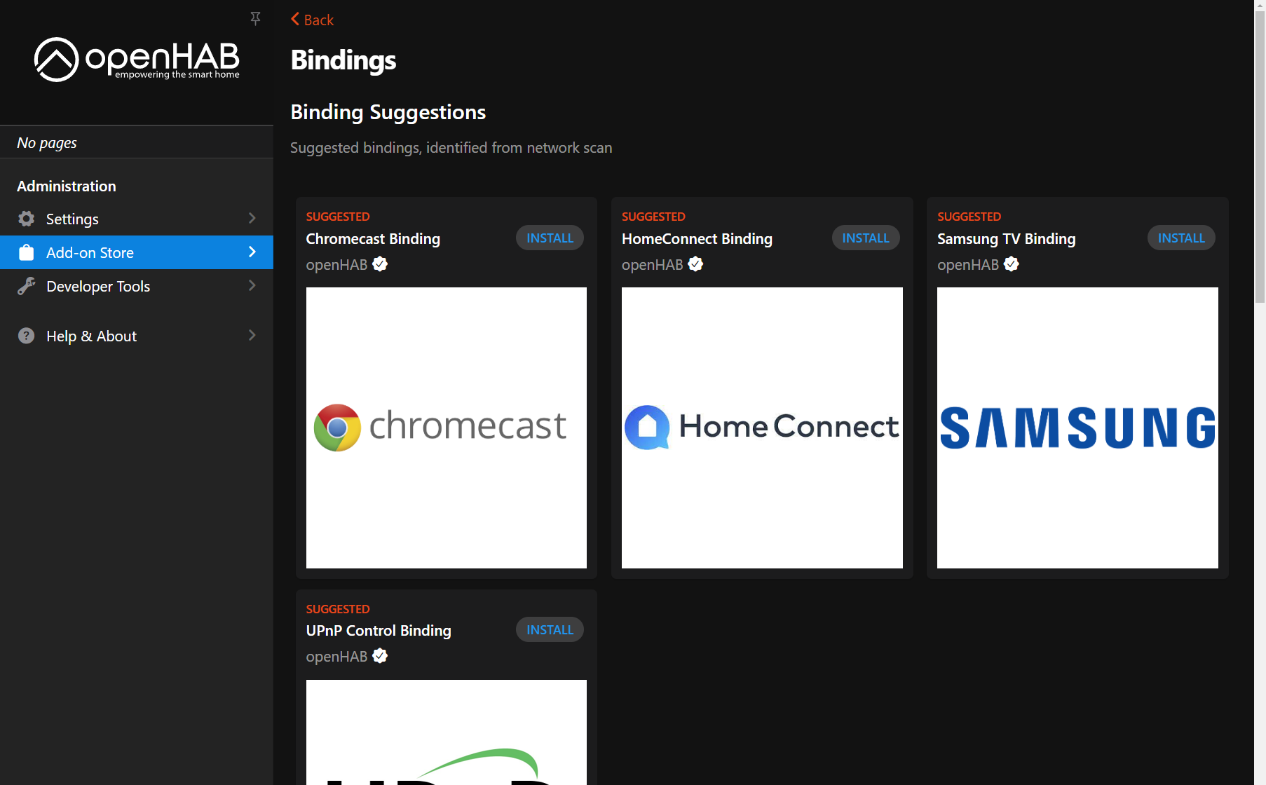

You will find it in the add-ons store under automation.
One of the other changes mentioned in all the 4 upgrade docs is Blockly. In OH3 Blockly is compiles to the older Nashorn js, but that has been upgraded now in OH4 to the newer JS Scripting. You need to install the JavaScript Scripting add-on (which is available given the output of your feature:list).
Then you need to look on the forums for information about getting each of the blockly rules updated. I believe that you just have to open each rule and re-save it again, but I don’t recall if there is more than that.
Then I have to do the obvious nomination for the UX from hell award. This is a very good example how to not design a good UI/UX. Or is this already nominated?
Ok but at least its solved and my recommendation is to consult a UI/UX designer to improve the user-journey. Im not available anymore though.
its also on the bottom of my screen, but thats the wrong place. Its the last place where something like this is to be expected, especially if you have menu bars on all other sides of the screen as well.
There are established patterns how to implement navigation bars and menus and how to design them, there is no reason for a little project to try something else thats not proven. As we can see, this attempt failed.
I once made a similar experience when Tibco moved the Spotfire tabs from top to bottom. A colleague then said you need to think like working with Excel where tabs are also at the bottom. So there is different software using tabs at the bottom - it is not only ‘for a little project to try something else thats not proven’.
Clearly not. You did not see it initially, and it does not show in the screenshot you provided. It seems that in your case it is at the bottom of the page and not at the bottom of the screen where it should be regardless of the length of the page. If you answer my question about your browser and device then maybe that issue can be diagnosed and addressed. Your complaint about the unintuitive location is based on faulty data because off-the-screen is not where it is for most other users. But, if you want it to be a better UX then you have to help by providing the information about what it is that caused your experience to go wrong.
