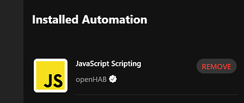

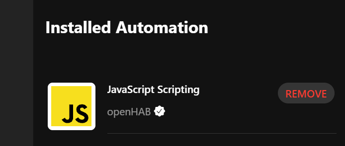

Why do I have to run this every time I update OH?
openhab> feature:install openhab-automation-jsscripting
Doesn’t persist through updates:
Have you ever edited $OH_CONF/addons.cfg? Is this the only add-on that needs to be reinstalled?
I’ve never installed an add-on using the Karaf console. When you install it that way, does it get added to $OH_USERDATA/config/org/openhab/addons.config?
Without further information all I could guess at is that using feature:install will add it until the next time the cache is cleared, which happens during an upgrade. It doesn’t actually permanently install it (i.e. it gets added to addons.config so OH know to reinstall it after a cache clearing).
Yes. This is the only thing acting up.
FYI: I’m on Ubuntu 26.04.1LTS
omr@shs3:~$ printenv | grep OH_
omr@shs3:~$ printenv | grep OPENHAB
OPENHAB_HOME=/usr/share/openhab
OPENHAB_USERDATA=/var/lib/openhab
OPENHAB_CONF=/etc/openhab
OPENHAB_HTTPS_PORT=8443
OPENHAB_BACKUPS=/var/lib/openhab/backups
OPENHAB_HTTP_PORT=8080
OPENHAB_LOGDIR=/var/log/openhab
OPENHAB_GROUP=openhab
OPENHAB_RUNTIME=/usr/share/openhab/runtime
OPENHAB_USER=openhab
omr@shs3:~$
No addons.cfg in @OPENHAB_CONF (and no OH_ env vars at all)
omr@shs3:~$ cat $OPENHAB_USERDATA/config/org/openhab/addons.config
:org.apache.felix.configadmin.revision:=L"181"
automation="jsscripting"
binding="ipcamera,wled,mail,samsungtv,systeminfo,daikin,matter,onkyo,harmonyhub,network,astro,nanoleaf,hyperion,squeezebox,denonmarantz,kodi,deconz,automower,zwave"
core-config-discovery-addon="usb,ip,sddp,upnp,mdns"
felix.fileinstall.filename="file:/var/lib/openhab/etc/org.openhab.addons.cfg"
includeIncompatible=B"true"
legacy="false"
misc=""
package="standard"
persistence=",influxdb"
remote=B"true"
service.bundleLocation="?openhab"
service.pid="org.openhab.addons"
transformation="regex,map,jsonpath,javascript"
ui="basic,habpanel"
omr@shs3:~$
Unless you deleted there should be one there. It’s all commented out but the file is put there as part of a standard OH install.
The next time the add-on disappears, check the userdata/config/org/openhab/addons.config file. Is “jsscripting” still listed next to “automation”?
You can force it I suspect by doing just an sudo openhab-cli clear-cache (or what ever the argument is, I run in docker so I don’t have openhab-cli and have to call the scripts manually).
I will check prior to next update.
