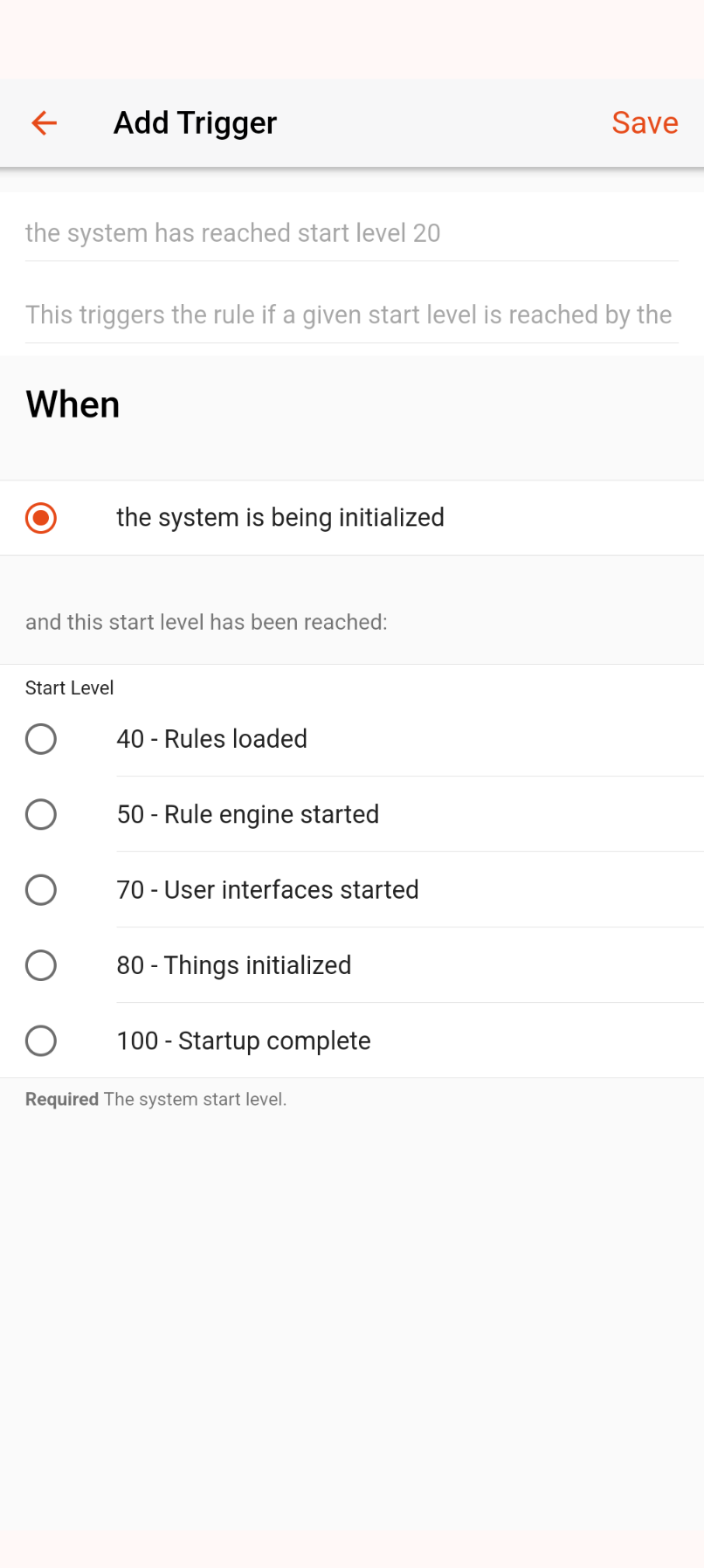

To be honest, I don’t know the difference between rls 40 and 50. I wouldn’t think any rules would be able to run until 50 anyway. I’ve always meant to ask about that.
You can’t get to run level 40 without successfully passing the earlier run levels so those can be ignored as outside the scope here. This is where Items are loaded and restoreOnStartup runs.
I figured that was a possibility too. But why hasn’t it reached 100 then?
Wrt to rules SL 40 means that rules are loaded and SL 50 that the rule engine has successfully started.
So SL triggers are only useful for SL 50 and above.
one or more of your Things is in an error state, neither ONLINE nor DISABLED.
So there is really no reason to offer rl 40 in the UI then, right?
I think so, but I might be missing something.
Probably we should ask the core maintainer.
