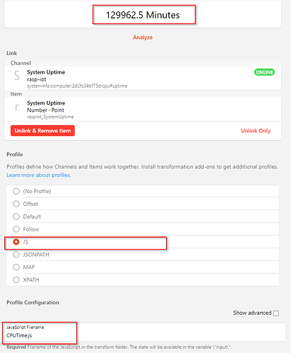

Ruben Fuser
Does anyone have this working in OH3?
Same question from my side.
Same picture. And, yes the javascript is being executed, but the result is not displayed.
No idea why…
It works in OH 3.3.
As the function returns a string, you should define the item as a String item, not a Number:
String LocalComputer_Cpu_SystemUptime “[JS(CPUTime.js):%s]”
I also added a semicolon to the line
var returnString =  stringDays + stringHours + stringMinutes;

In fact I was using the main UI with the JS profile. I was not aware that there were differences between the two methods. Thank you for clarifying this.
But my remark about using a String item is definitely the solution for the problem of @smarthomepch. He also uses the JS profile in the link.
